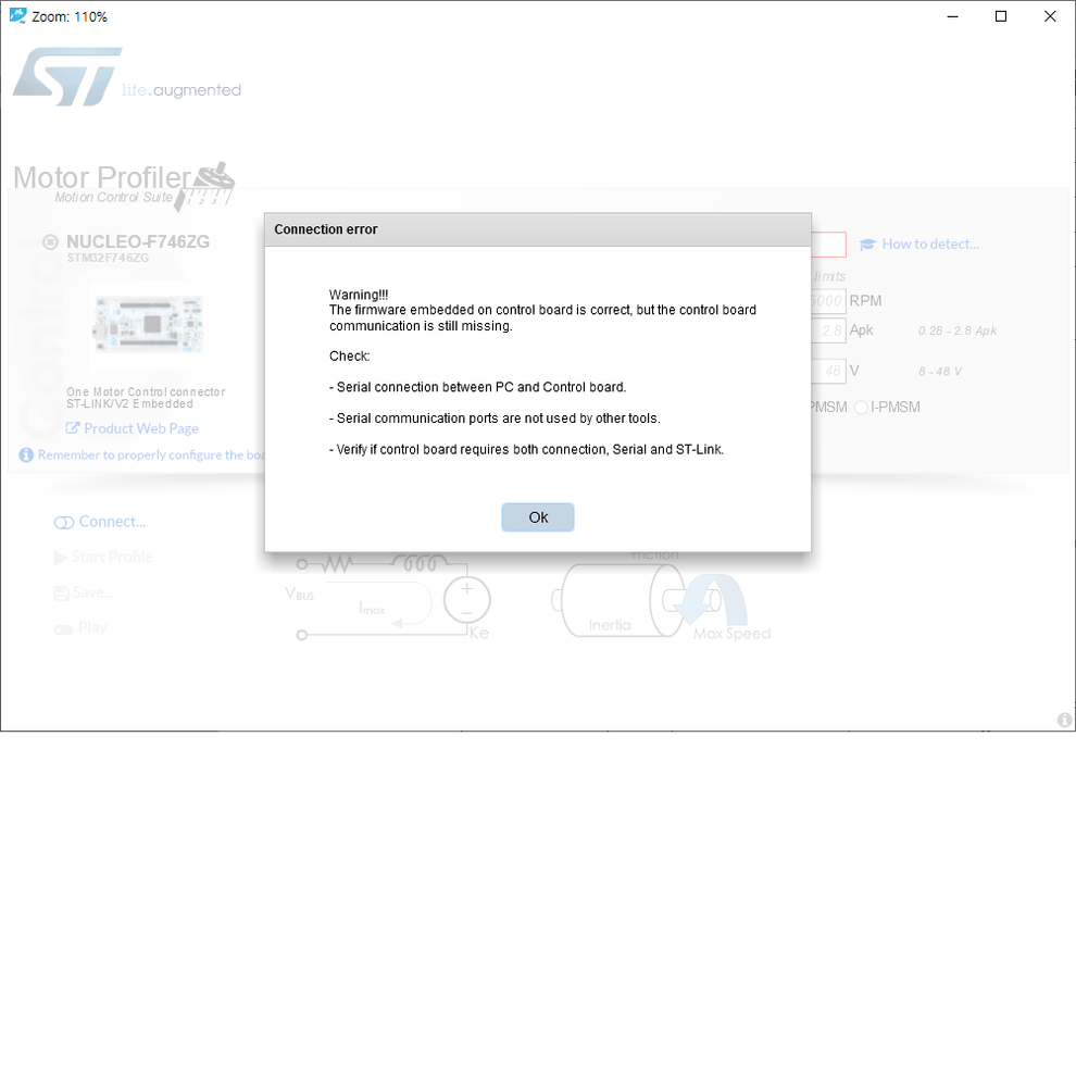

Hi, I'd like to run the bldc with (NUCLEO-F746ZG + IHM07M1), so I tried to use 'ST Motor Profiler', but the program said that 'control board communication still missing'.
​I did remove the Solder bridges and powered 12V on power board, connected the USB to st link board on nucleo board.
If I disassemble the nucleo board and IHM07M1, the board response to the profile program.
​I checked the IHM07M1 with nucleo F446re board and I figure out that the IHM07M1 isn't broken.
On the profile program, the nucleo 746 board is one of the default setting with IHM07M1.
Is there any missing to run the BLDC using 746board?

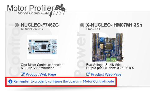

Hello @Rsi​,
did you properly configure the boards in Motor Control mode?
You can find the configuration procedure step-by-step clicking on the "info" message:
0693W000007EM4BQAW.pngLet me know if this info is useful to correctly setup the boards.
If you feel a post has answered your question, please click "Accept as Solution"

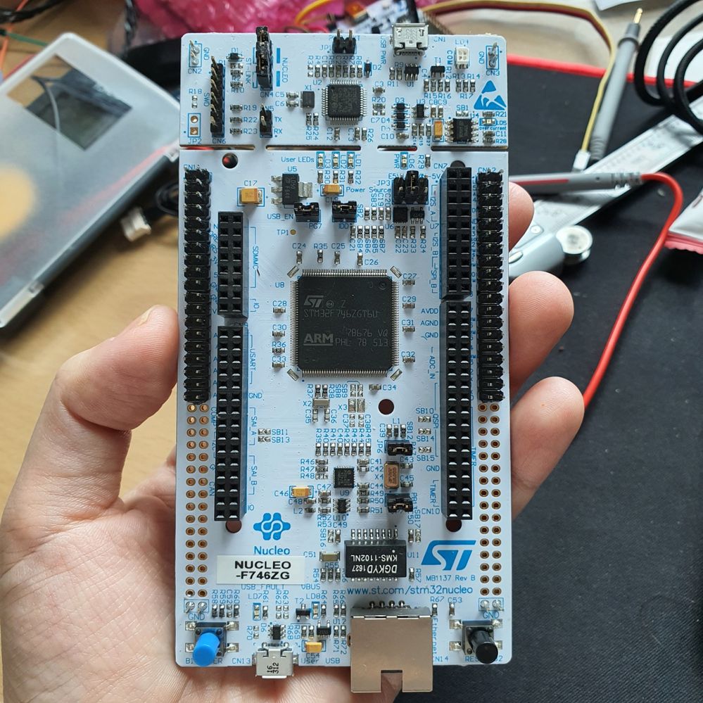

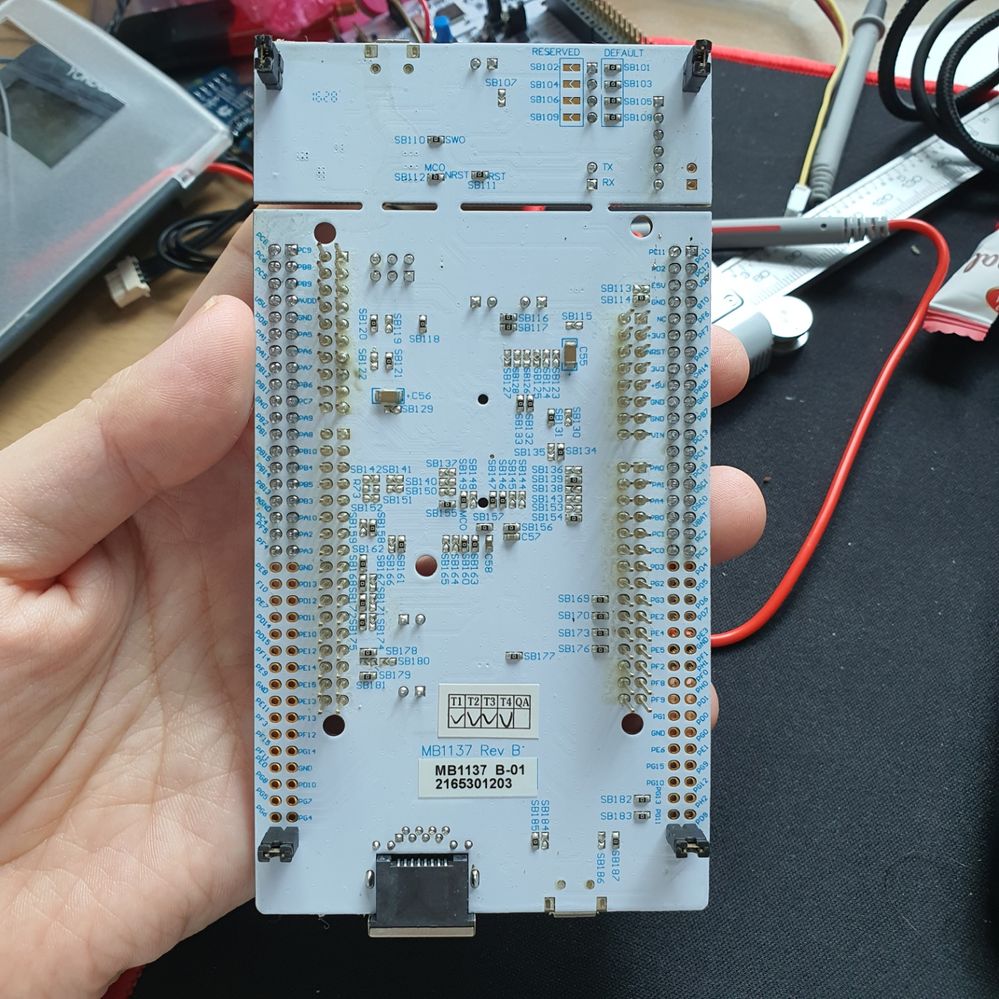

Rsi
@Cristiana SCARAMEL​
Thank you so much for replying.
Of course I did it.
My project still on pause state.
this is my board.
