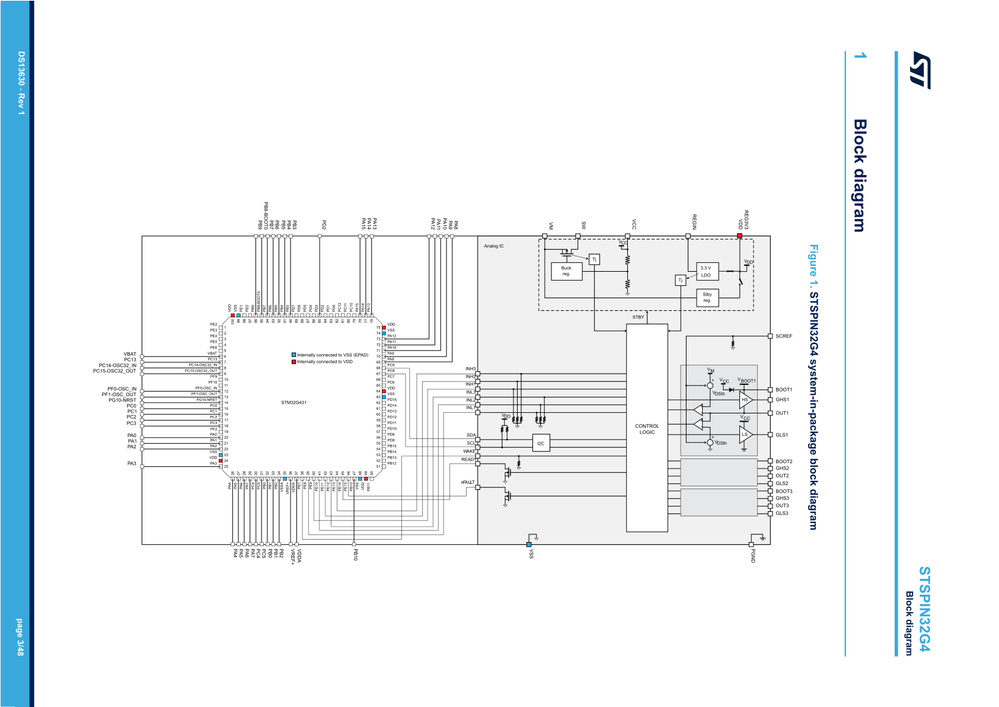

We are trying to use STSPIN32G4 Evolution board for our ventilator air blower driver application.
We are facing the problem that we are receiving Speed feedback error while we connect our motor with STSPIN board via ST's Motor Driver Workbench (Motor Pilot) Software.
To check if GATE pin of high side MOSFET receives PWM or NOT, We are trying to toggle the High side switch of STSPIN(INH1) i.e GPIO pin PE9 and checked with the oscilloscope.
The pin is not toggled only the voltage 12V is shown on that pin.
My question is, is it possible view the given PWM to the GATE pin of high side MOSFET via microcontroller pin or the PWM logic is controlled by the logic circuit i.e inside of the STSPIN.
How to remove speed feeback error.

waclawek.jan
Looks PWM lines (PE8..PE13) are inside and not exposed:
Thanks for the reply,
I have the doubt, as follows
If i toggle PE9 pin, is INH1 pin will toggle or not.
waclawek.jan
Those signals are interconnected internally inside the package, they are not brought out to external pins.
