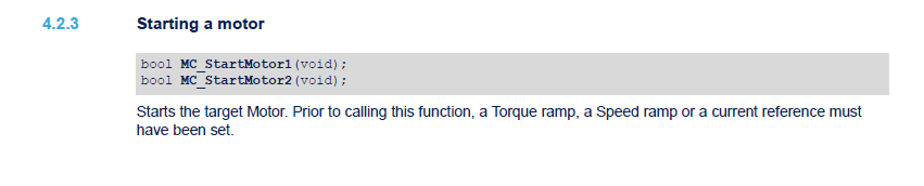

Hey @cedric H​ . Hope you are in good health. Thank you for your answer. This is what I did but it looks like there is another underlying problem in the motor control middleware that is not allowing me to do so.
I used MC_SetCurrentReferenceMotor1 with the expectation that it will help me align the motor and I was wrong.
I'm using a 24V 15P-P 730RPMmax Motor with B-G431B-ESC1 with hall sensors. I have configured it accordingly both in the Motor Tab and Speed Sensing tab of the MC WB. The pins assigned in the Digital I/O tab are also correct. I am driving the motor with speed control. This motor has been profiled using ST Motor Profiler.
Yet, I'm not able to run the motor. I've observed that MX_MotorControl_Init only initializes the motor and programs speed ramp with the target value assigned in the MC WB. Hence, I called the MC_StartMotor1(); function in order to start the programed ramp. This is not working for me. I'm having a speed feedback error and i do not know what might be causing this. What is the process of starting the motor with hall sensors otherwise?
PS: Although the motor needs big time tuning of the PI values, I'm able to move the motor to desired target speed (RPM) in the sensorless speed control mode. I wish to run the motor with sensored speed control mode since I also need to achieve position control. Need your assistance in controlling it with sensors.
Regards
I found the following information in the MC Docs.0693W00000Y7MZcQAN.pngMy question is, if I use Hall Sensors as speed sensing, which of the above (torque ramp, speed ramp or current ref) do I set in order to start motor successfully?

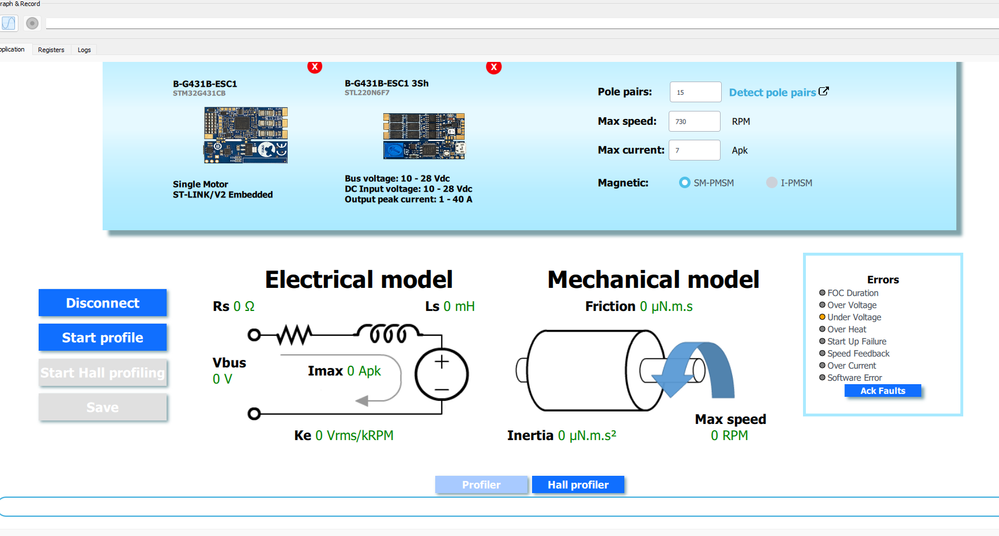

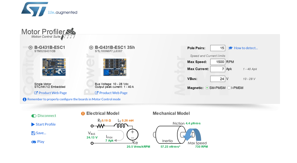

Hey @cedric H​ ,
I have profiled previously mentioned motor using both MC prof 6.0 and 6.1.
6.1 seems to have voltage issues since there is no max voltage parameter that we can input. I either get undervoltage or overvoltage faults. Let me share the pictures:
MC profiler 6.0:
MC profiler 6.1:
0693W00000Y7OSEQA3.png6.1 has voltage calculation issues. The profiling fails every time. Please note that I'm not even giving extra RPM (730RPM) in 6.1, while I have actually provided 1500RPM in 6.0 and it still profiled fine for 730RPM.
Also, I'm not able to profile Hall Sensors.
I have disassembled my motor so I can see the order of Hall Sensors placed in the Motor. I might be going wrong in the "Placement Electrical Angle". I've provided it has 60 degree right now.
