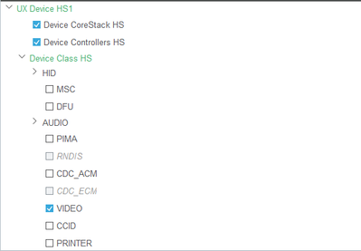

I’m working with the STM32N6570-DK board and trying to implement a USB Video Class (UVC) device.
From my exploration in STM32CubeMX, I couldn’t find any native option to enable or generate a UVC class . Based on this, my understanding is:
  • UVC is not directly supported in STM32CubeMX
  • It may require manual porting (e.g., from X-CUBE-WEBCAM or other examples)
Could you please confirm:
  1. Is UVC officially supported on STM32N6570-DK?
  2. Is there any roadmap to include UVC support in STM32CubeMX?
  3. Are there any reference implementations (for STM32N6 or similar series) available?
  4. What is the recommended approach:
    • Should we start from a CubeMX-generated USB project and manually integrate UVC class?
    • Or is there a preferred middleware/package for this?
Additionally, it would be very helpful if you could outline the  high-level steps for implementing UVC on this platform .

Hello @MSGokul
Indeed, you can select VIDEO class using STM32CubeMX as you can see in the caption
You can base yourself from this cube example
You can start from a pure STM32CubeMX project and implement the necessary functions from the example, then customize the project. Alternatively, you can start directly from the STM32Cube example and modify it as required.
