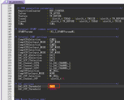

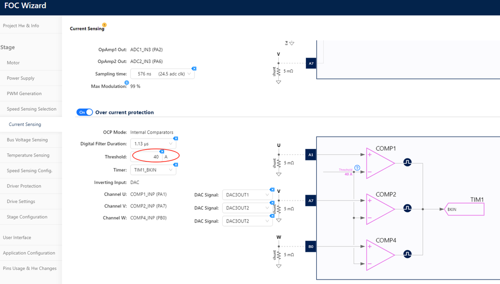

I have an EVSPIN32G4 evaluation board with a sampling resistor of 0.005Ω.
Why does a current of 40A correspond to a threshold of 7427 (0.37V)?

3.3V corresponds to 65535 hence 7427 correspond to 0.37V. How 40A is achieved you can go through the document attached, there is section on over current protection.

(VDAC - 0.198 V) * 227 A/V
