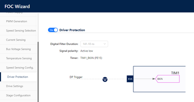

Did you enable the Driver Protection feature to report errors from the STSPIN32G4 device?

You mean the undervoltage and overcurrent protection in the driver section? It is enabled by default in the program, and I haven’t changed it. I read the status register and no protection had been triggered. Also, I found that when setting the register, only setting VCC_VAL and changing the voltage to a value other than 8V will cause the entire system to power off and trigger undervoltage protection. I’d like to ask for your advice. Thank you.

I mentioned Driver Protection.
Refer to section 5.5.3 nFAULT output of the STSPIN32G4 Datasheet document for more details.

Hello, I haven’t used the motor library and haven’t configured the BKIN section; I’m simply generating PWM on six channels and reading the pin levels via (GPIOE->IDR & GPIO_PIN_13). When viewed on the host computer, there is a constant PWM output, but once the motor is driven, there is no PWM.
