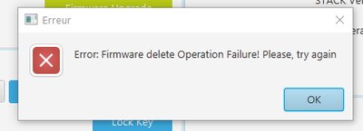

I also have an error when trying to use the "Firmware delete" option:
I already tried to mass erase the chip, already tried to flash previous FUS version, nothing worked... I always have the FUS_STATE_IMG_NOT_FOUND warning.

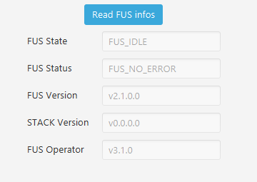

This is my current state:
I have no read protection (option byte set to AA).
I am using CubeProgrammer v2.14.0 and STM32Cube_FW_WB_V1.23.0.

Issue solved after switching to latest STM32CubeProgrammer version (2.20.0)
