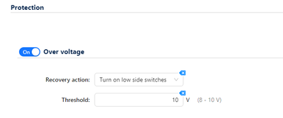

I am currently designing an ESC for a small vehicle (around 300g).  I made a first proto board and I use the 6-steps algorithm with an hall sensored motor. I would like to be able to brake. I firstly thought to short all the phases directly to the ground with a PWM in order to brake more or less but it seems that there is no dedicated function  for braking in the generated project.

What is the best way to brake ? Is it mandatory to add the load resistor ? In the commercial ESC for RC cars, there is a brake function but it doesn't seem to have a load resistor.
If I make a negative speed ramp, is it going to brake ? Or it is just decelerate with the inertia ?

Best answer by Fabrice LOUBEYRE
Hi Xavier, you will find attached two updated files to add into your MCSDK 6.3.2 project to make the "turn on low side feature" of the over voltage compile.
In addition, as an example, the stop action has been updated with the same brake feature by calling the PWMC_TurnOnLowSides.
Best regards.
Fabrice

Hello I tried to activate the following function :
But unfortunatly I  have the following error when compiling :
.st_workbench/projects/6_step_config_hall/Src/mc_tasks.c:440:(.text.TSK_SafetyTask_LSON+0xc): undefined reference to `PWMC_GetTurnOnLowSidesAction'
Any help ?

Hi Xavier75, unfortunately, this over voltage configuration does not work into the current 6step implementation. Sorry for the inconvenience of this compilation issue. A correction is scheduled for MCSDK6.4.0 version.
however, the function used to brake the motor if the over voltage error occurs in "turn on low side feature" is the following: PWMC_TurnOnLowSides that switches on the PWN Low Side to generate a brake.
Witch version of the MCSDK are you using? MCSDK6.3.2?
