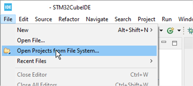

every time i generate and open the folder .project file doesn't opend. i am using steval-spin3202
vacha.1
1 REPLY 1
GMA
If your point is to open a generated project with CubeIDE, you can launch directly CubeIDE, and load the project by using:
0693W00000UoMk6QAF.pngAnd select the STM32CubeIDE directory in your project folder:

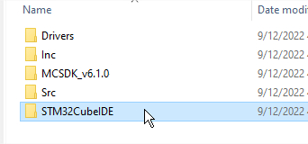

0693W00000UoMlEQAV.pngBest regards.
