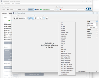

‎2024-11-14 12:16 AM
Hello @Danu_Park,
Could you verify motor connect connection: U, V and W phases and Encoder signal?
Did you try using Sensor Less as Main speed sensing and Encoder as Auxiliary to check that both reported electrical angles are aligned?
Best regards.

‎2024-11-15 7:53 AM
Hello @Danu_Park,
Using Motor Control Pilot tool, "Graph & Record" left button, and select ELectrical ANGLEs to display:
Best regards.

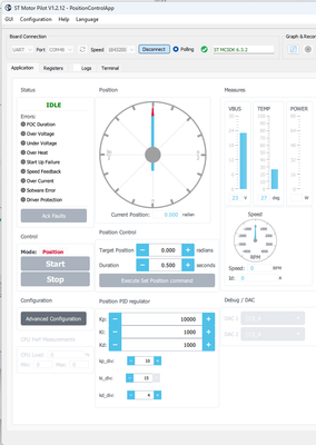

‎2024-11-18 12:28 AM
Hello @Danu_Park,
Using Motor Control Pilot "Advanced Configuration", you can tune the position control PID regulator:
Best regards.
