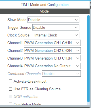

I am using Timer 1 for the generation of 3PWM and their complimentary Signals and I am getting all 6 PWM waveforms.
For six step commutation I need to add phase delay between the channels of the timer. Is it possible using any HAL function? I am not using any motor control library or example code.

Hello @Issamos
I referred to that video but my hardware has been developed and it uses only Timer 1 for PWM generation -> Chanel1,2&3 Please refer the below snap.
Can you please help me in this scenario, I need to start the Timer 1, Channel 2 PWM 120 degree apart

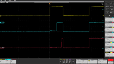

Hello @Issamos,
I did the as you said and it worked for only 1st cycle.

Hello @ajishsaji
I'm sorry but you should use different timer for each pwm. And take care of timers internal trigger connections. As described her.

Hello @Sarra.S & @Issamos,
I am using the microcontroller STM32f030R8T6, and my hardware is fixed and it has been mapped to the pins of the timer 1 because I need 3 PWM signals and their complimentary signals.
I am unclear about the match mode can you please elaborate.
