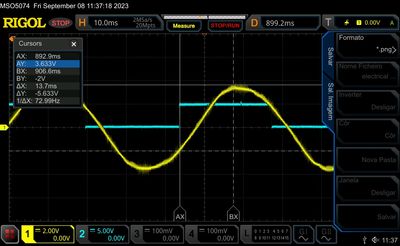

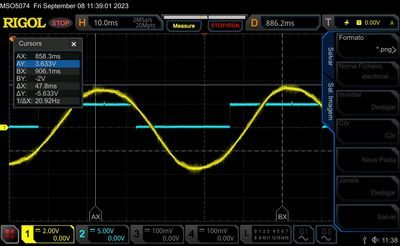

From the look of it, maybe there is an issue with your Hall Sensor setup. Have you correctly configured your "Sensors displacement" and "Placement electrical angle" ? You can change them by clicking on the motor in your WorkBench project, then on "Sensors" tab.
The determination of both values is well explained in MCSDK 6.1.2 documentation. You can access it by executing WB 6.1.2, clicking "About", then "Documentations". The information you are looking for is at the end of the "Hall sensor feedback processing" section in the User Manual.
Hope this will help,
Gaël A.
If you agree with my answer, please consider accepting it by clicking on 'Accept as solution'.
Gaël A.
Hi @Gael A thanks for the sugestion.
From the following images I calculated 259° (-101°).
But even changing that, the motor response on turn on was the same

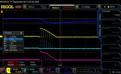

Phase A (Yellow)
Phase B (Light blue)
Phase C (Purple)
Current sensor (dark blue)
Note that the current sensor points 1.9V (450A -> 5V; 0A -> 2.5V; -450A -> 0V). This indicates -108A out of a 5Amax power supply. This event triggers the power supply protection, then reducing the Voltage output, as shown on the phase voltages.
What else could be doing it?

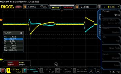

 Phase U - Blue
   Phase V - Yellow
   When Phase U is on 67.5A (2.875V), Phase V is on -90A (2V), thus Phase W is on 22.5A.
Does it means that the motor is trying to pull 90A from the power supply?
