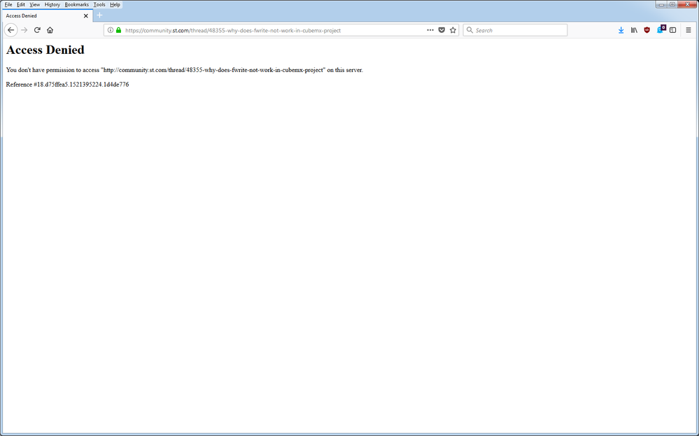

This post flags up a red line, and when I first clicked on the thread it locked me out of two browser sessions, with an 'Access Denied' message. Something weird with your account metadata me thinks.

I've pinged Jive/Aurea on this, sorry for the annoyance this issue is causing to you all
