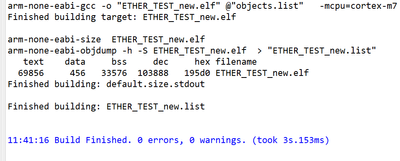

The project needs to be added to the workspace correctly.
First, remove it from the workspace. Then, either:
  • After clicking Generate Code, press the "Open Project" button
  • or, Open the .project file from the filesystem.
If you do that, it will build successfully:

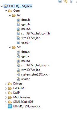

Segal
Hi there,
Maybe a part of my issue: the project was not save in the CubeIDE workspace.
Now that I copied it in the workspace I can see the right files tree:

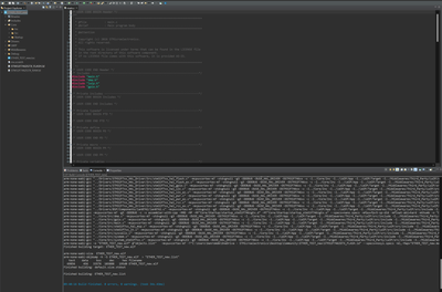

But I get a new problem: I can't build the project neither save it. Some Icons are not actives in the Toolbar.
What I Am doing wrong?
Thanks for help
Hello @Segal ,
As mentioned @TDK, the project was generated correctly and the compilation completed without any errors.
I recommend that you delete the project under the workspace and regenerate the code.
Thanks.
