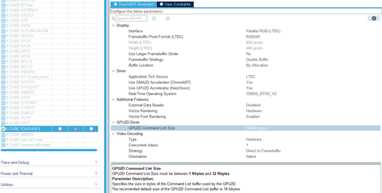

You cannot directly control the entire NEMAGFX_MEM_POOL_SIZE from STM32CubeMX. The size is determined by the command list size, which you can configure in X-CUBE-TOUCHGFX in STM32CubeMX, and 8 KB required for other Nema allocations.
Based on your description, I assume that you have updated an older project to TouchGFX 4.25.0 or newer. In TouchGFX 4.25.0, the default command list size was increased from 8 KB to 16 KB to provide significant performance improvements in certain situations.
If you want to revert this change, you can set the command list size to 8 KB in STM32CubeMX.
