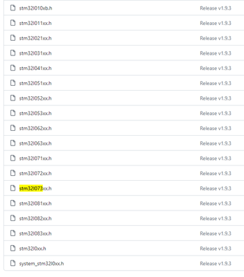

Where to find header file for STM32L073RZT6? I'm unable to find.
Mohsin
How to use header file in our code?
SofLit
Hello and welcome to the community:
There is no header file for this exact part number (RZT6) but for STM32L073xx. It's available on the CubeHAL in github:
https://github.com/STMicroelectronics/cmsis_device_l0/tree/b3b1d7b134f5408c3e75363754d44a6aa11b1db1/Include:
PS: This is NOT an online support (https://ols.st.com) but a collaborative space. So please be polite in your reply. Otherwise, it will be reported as inappropriate and you will be permanently blacklisted from my help/support.

Mohsin
Thanks a lot! for answering my query.
Just include main.h. That should always include the correct header.
