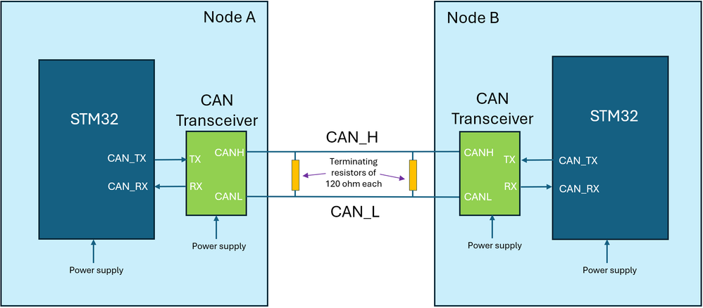

mƎALLEmBest answer
@adarsh_k_96 wrote:
Currently, no other CAN nodes are connected. I'm monitoring the pin states with a logic analyzer.
You cannot do that in Normal mode.
hfdcan1.Init.Mode = FDCAN_MODE_NORMAL;
This is the minimum hardware required to establish a CAN bus:
You need at least another node on the bus for the acknowledgement mechanism. CAN is not UART or SPI to use it in stand alone.
Use External loopback mode instead, where you can use one node in stand alone and monitor the Tx pin.
Hope that helps.

mƎALLEmBest answer
Hope that helps.
