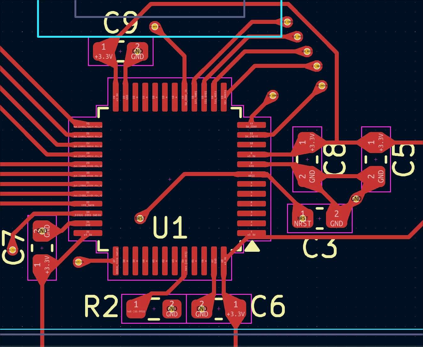

I have built and assembled a custom PCB board with an STM32U083CC on it. I have made 5 boards, after the first two did not work, I only populated the minimum on the other three. However, I am unable to debug or event connect to it through any means I tried, and I fear I have a systematic error in my schematic or workflow.
I connect to the target over SWD, using a NUCLEO-WL55JC1 board on which I have removed both JP1 and JP7, as well as attached directly to the JP8 headers. I have independently tried using a picoprobe, which gave the same result: Seemingly no answer from the MCU, as both programs report a timeout when trying to communicate with the target.

- I have NRST connected to GND via a 100nF cap
- BOOT0 is connected to ground via a 10K resistance (although it shouldn't matter with factory settings)

The PCB itself is a two-layer PCB, with a GND fill on the back, and the MCU on the front. I have also attached an image of the front layer, showing the MCU as well as the capacitors/resistance around it.
I am assuming the FAB has not done a mistake here, but checking for continuity between the debug header as well as the corresponding pad is correct.

I also made some measurements for current consumption, and when turning on it uses about 5mA. When NRST is pulled low, that drops to 0.1mA and stays there after it is no longer pulled low. Only reconnecting power brings it back to the initial 5mA.
Best answer by MaMuller
Alright, having talked to someone with more experience the problem was the NRST pin.
The manual does specify that there is a pull-up for it internally, but it is not meant to drive it. It kind of hints at this vaguely.
Adding a 4.3k Ohm resistor to pull NRST up, and the chip starts chatting!
The solution was, as I expected, very simple: NRST needs to be pulled high externally as well.
