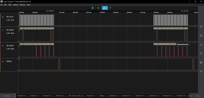

In the following I have set a debug gpio when the ISR finishes and reset the same gpio when the main function has processed the TxBuffer. From this it is clear that the new Txbuffer ready when a new transaction begins.
DEBUGDEBUG
Issue with partial transmission indicates there might still be a timing problem or insufficient synchronization between buffer updates and DMA transfers.
Even with msgReceived flag, there can be a problem if:
  • The buffer is being updated too soon after starting a DMA transfer.
  • The DMA transfer is re-triggered before the buffer update is fully complete.

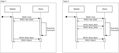

I have been working on implementing the double buffering setup, but haven't been able to achieve the desired functionality. How would you implement the double buffering or the atomic operations?
I have sketched a sequence diagram which illustrates the desired functionality, which I hope to achieve from solving the problem which I have stated.
Sequence DiagramSequence Diagram
OBS: The two cases show how the slave should respond when the slave is busy and when it is done executing.
