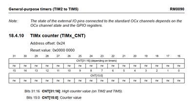

Hello, ST expert
STM32F407 is used for our custom design. And htim2 play the role of precise timing base.
When htim2->Instance.CNT = xx  is used for setting a new counter start value for timer2, it seems that the new counter value does not functions immediately, I mean that the next counter value does not appear one clock period later.
Is there any timing diagram when TIMx_CNT register is written by user program?
BR
Yang
Best answer by waclawek.jan
As you haven't posted further details, let me guess: you have an external interrupt (EXTI) set to trigger upon edge on the GPS PPS signal, and in the interrupt service routine, you decide upon some flag, whether
A) to set TIM2_CNT or
B) to read out its value and store/check/process.
If yes, then the main difference is in the amount of software executed for those two cases A) and B).

There isn't
Several things clocking at different speeds, assume write to AHB->APB is going to take in the order of 4 cycles. and is deferred through 2 write buffers. You need to use a fencing instruction like DSB or a memory read to force completion / in-order-execution
The TIM are synchronous, but can run at 2x the APB clock, the prescaler (PSC) is not visible to you, so CNT may latch vs count apt to be somewhat unpredictable for PSC != 0

Hello, BarryWhit
I am sorry for the unclear description. I am talking about the TIMx_CNT register.
True, as @Tesla DeLorean said above too; but why does it matter?

Hello, jan
According to my measurement, it takes effect after about 4 micro seconds in the case of 8MHz CPU main frequency, 4MHz htim2 clock frequency. That means the next counter value appears 4 micro seconds later. I am not sure this is correct. Is 4 micro seconds delay possible?
In our application, the interval between two successive GPS PPS(pulse per second) signal should be recorded precisely. E.g. After the first PPS, the htim2->Instance.CNT set to 0, and when the next PPS comes, the interval is recorded using the change of htim2. And I found that the first interval is always 1 second minus 4 micro second, but the later intervals are always precise 1 second. So I doubt that the reason is the delay.
BR
Yang
waclawek.jan
waclawek.janBest answer
June 24, 2024
