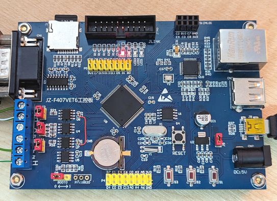

I have the following Board with an STM32F407VET:

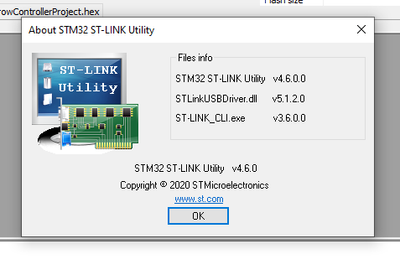

Maybe I should add that I'm unable to flash via STM32CubeIDE with my ST-Link V2 "CN edition".

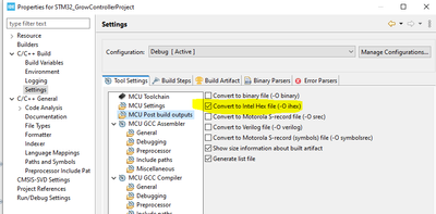

So i'm creating the .hex file and flash it via the STM32 ST-Link Utility

PS: ST-Link Utility is a deprecated tool and no more supported. Use STM32CubeProgrammer instead.

Hello, I am having trouble finding the Datasheet of the exact development board based on (STM32F407VET6) you are using, Could you share where you got your datasheet.
splasher
https://github.com/art103/JZ-F407VET6
There is one pull request where the pdf is attached.
That's everything I found
