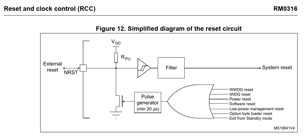

I need to know the timing constraints for bootloading (over UART). How long must \RESET be held low to reset? How long must BOOT0 remain high after \RESET is released? I need this for the STM32L4P5, the STM32F423, and the STM32G031. I apologize in advance, since it is certainly published somewhere, but I couldn't find it.

so here from ds+rm F303 , cortex M4 core :
reset:
and boot mode set:
- reset min 20us , to be shure, i would make 10ms and fine.
- boot is set after 4 sysclks after reset...i would make > 1ms and fine.
- to be shure, for your different chips, look in the respective manuals (timings might be different)
