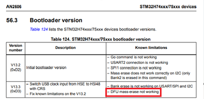

Hi @FBL ,
Is there a way to check the bootloader version on the stm32h743 without direct access to the code and if the CubeProgrammer says -- instead of bootloader version and revision number?
EDIT: on my chip it says stm32h743vih6 78 a4a v0 v phl 78 135
The code gets into an infinite loop after sending mass-erase, but sometimes it passes.
I'm trying to figure out if I have this version where the DFU mass-erase is not working.
Thanks,
Strongato

I also realised that when I use the f446 as host instead of g0, the h7 device does mass erase fine, so it's probably a stability issue on my g0, not the ST bootloader.

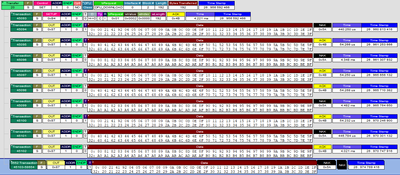

We acquired a usb analyzer, and the weird thing that I noticed was that the F446 as host, after being NAK'd, does not retry the same packet, while the G0 and PC do?
F446 Host: 128 byte transfer that works:
F446 Host: 192 byte transfer that fails:
As you can see, the packets that are NAK'd are not retried, they just loop.
While the G0 as host does retry the NAK'd packet:
I'm also sending the .usb files of the f446 transfers.
My assumption is that the FIFO buffer does not get flushed on every NAK, but it just sends what's already inside.
