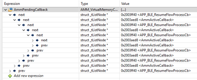

I'm having trouble with our BLE app where our code gets stuck in an infinite loop in `stm_list.c`, specifically in the `passPendingToActive()` function.
When I expand the `AmmPendingCallback` variable in CubeIDE, I see this:
And following the logic through of the passPendingToActive() it seems like we'll never recover from this. The application becomes unresponsive.

I suspect the fact that we're abusing the BLE thread is what's causing this, but in any case it seems like incorrect behavior. The LST_is_empty (&AmmPendingCallback) check is never TRUE, so the while loop never exits.

Set a hardware watchpoint to figure out when and where the list gets modified with a link to itself.
What's interesting is it seems like it's not a one-step loop -- it's more like A -> B -> A -> ... (see image above). I'm not exactly sure what to check with the hardware watchpoint. Here's the contents of passPendingToActive():

I put a breakpoint in pushPending() while stuck in this loop, and that never halted. That's what makes me suspect a logic error someplace.
