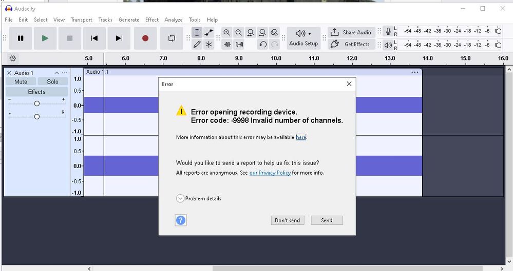

I am implementing a USB Audio Class 1.0 microphone on an STM32 (Full-Speed only).
The device enumerates correctly on Windows and appears as a 4-channel microphone in the Sound Control Panel, but no WASAPI-based application can open the input stream.
When using Audacity with WASAPI, the device exposes only 1–2 input channels and recording cannot be started.
For USB Audio Class 1.0 Full-Speed microphones on Windows, I have the following questions:
  1. Are Sampling Frequency Control requests (GET_CUR / SET_CUR) required even if the device supports only a fixed sample rate of 48 kHz?
  2. Is the presence of a Master Feature Unit (Volume and/or Mute control) required for Windows/WASAPI to successfully open the audio stream?
  3. Are there any mandatory class-specific control requests that must be implemented (i.e. must not be STALLed) to avoid WASAPI stream open failures?

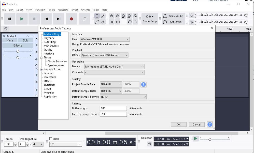

Setup:
  • STM32 USB Device (FS)
  • UAC 1.0, Isochronous IN (microphone)
  • PCM, 48 kHz, 16 bit, 4 channels
  • Iso IN Endpoint: Adaptive
  • Windows 11
File with descriptor file is attached below. Thanks in advance!

You see? Same problem. I also got same issue  on STM32H743iitAudiosity.JPGAudiosity_1.JPG
