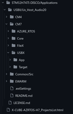

Hello, A USBX Host Audio 2.0 example alpha package is available now on GitHub: https://github.com/STMicroelectronics/x-cube-azrtos-h7/tree/dev/usbx/Projects/STM32H747I-DISCO/Applications/USBX/Ux_Host_Audio20 Kind Regards,
thx for info !
i tried import to cubeIDE...
but there is no IDE project with .ioc file, only for using IAR !
so : STM developers not using STM32CubeIDE ?? or why ..?

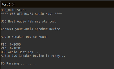

hm -- seems so.
difficult to find out, what is missing or wrong...but now:
just sd-card not working now , no physical read - but it worked before... :(
