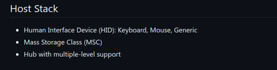

Just drop the broken bloatware and start using a decent software developed by people, who actually know what they are doing:
https://github.com/hathach/tinyusb
Post edited to adhere community guidelines.

I looked now at that page, the readme has one line, not exactly encouraging.  Have you got it working on an H-series for 192KHz+ audio streaming?
