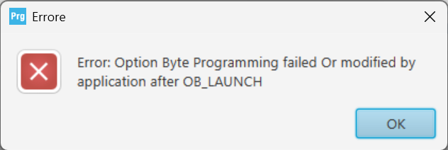

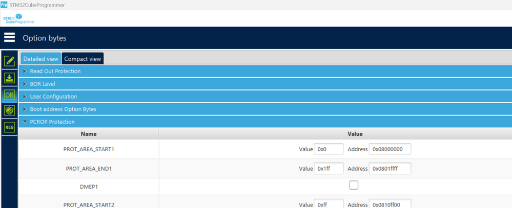

After tinkering around a bit to understand its functions, I can no longer reset its protection to its default state. Currently, it looks like the one in the photo:
When I try to set these values
PROT_AREA_START1 = 0x0801FF00
PROT_AREA_END1 = 0x080100FF
which i believe are their default values, both in the RDP=0xAA and RDP=0xBB states, I get this error.
How can I fix this? Is there a way to reset PCROP Protection to its default mode?

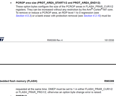

yes, you can reset the PCROP, but only when the RDP is changed at the same time:
Which means that you need to set the RDP to 0xBB and then, in the same step, request both RDP=0xAA and the PCROP modification.

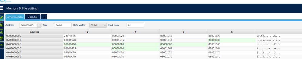

Here's the sequence of how I write data to that flash area, again using the STM32Cubeprogrammer tool:
  • I load from a binary file, and that area is populated as shown in the following figure:

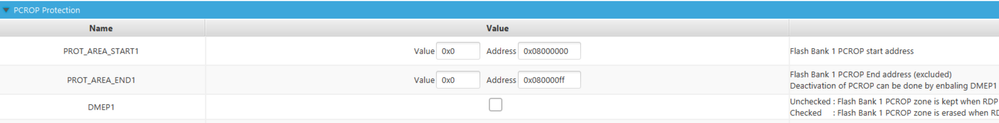

  • I enable PCROP only for that area of ​​sector 0, as shown in the following figure:

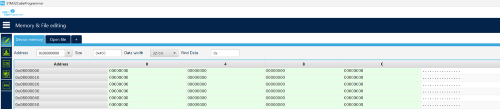

  • After that, I reread the data in that flash area. I see that we're all zero, as shown in the following figure:
Is there a way to prevent it from returning zero, but instead return data from binary files as before, but still need to be protected by PCROP during the regression from RDP = 1 to RDP = 0?

I simply write data and verify that they are populated on STM32CubeProgrammer and it's ok. Then I enable PCROP and DMEP = 0 only for that area and then I recheck that they are still populated on STM32CubeProgrammer and instead they are all populated at 0x00000000 for that area of ​​sector 0.
