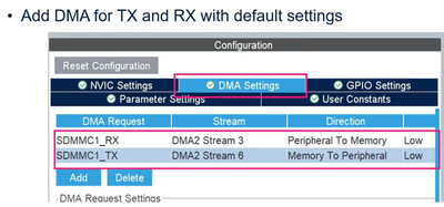

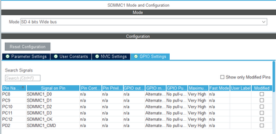

‎2025-01-09 8:34 AM
@mÆŽALLEm wrote:Not possible to provide ioc file for each case/board.
The video is simple and you can easily follow it. You need just the SDcard detection not the all configuration of FatFs.
Now after watching the video, In my configuration I can't see I don't see the DMA Settings tab, is it normal ?
In the video I can see this tab :
Is this due to the type of microprocessor or the STMCube IDE environment which is not up to date ?
Thank you for your answer
