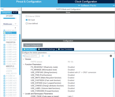

As you are using CubeMx I invite you to watch that video especially at 5:59 on how to configure SDcard pin detection on CubeMx.
Hope that gives you more visibility on the subject.

Did you see the start of my topic ? For 1 line of code there are 4 or 5 references and it becomes unreadable. Of course, putting the code on the SD card is easy when you know it, but when you start, for me it is better to start with CubeMX and eventually complete it later.
CubeMx helps you to speed up the development but needs from you to understand what you are doing.
Did you watch the video of the card detection config with CubeMx that I shared in a previous comment?
