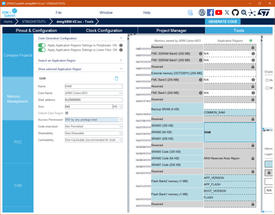

Settings:
STM32CubeMX 6.14.1
STM32H573VI
STM32CubeIDE v1.18.1
I am not quite sure, but up to my understanding the Memory Managment Tool has a bug when it comes to the "Access Permissions" settings.
When RAM is set-up like this (Access Permission set to "RW by priviledged code only"):
It creates an initialization code for the GTZC1 that disables priviledge checking for the SRAM:

But when RAM is set-up like this (Access Permission set to "RW by any priviledge level"):
It creates an initialization code for the GTZC1 that enables priviledge checking for the SRAM:

Maybe I do not understand the intention behind this setting correctly, but in my optinion it should be exactly vice-versa.
This caused me some headaches while trying to find out why GPDMA1 was not able to write any data into the RAM.
