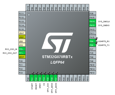

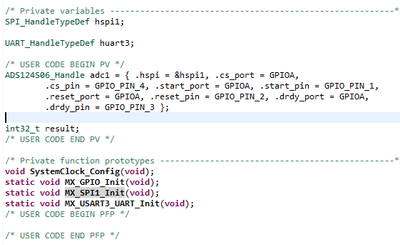

GPIO Configuration:

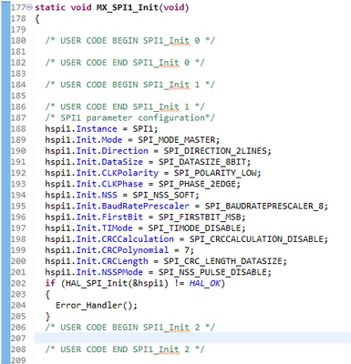

SPI Configuartion:
Clock Configuration:

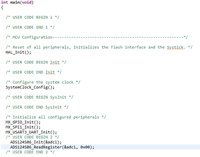

Code :
spdkalyan_6-1752647510127.pngspdkalyan_4-1752647346103.pngspdkalyan_5-1752647388169.png

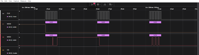

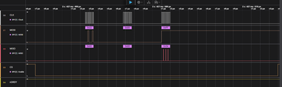

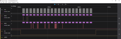

this is what I'm doing. I've configured all the SPI settings as per the datasheet of ADS124S06 and able to receive the data on MISO line,
I've verified it using logic analyser.

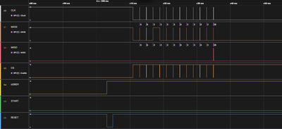

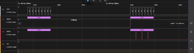

written data zoom out view
read data RREG
zoom out view
by seeing the logic analyser output, I can say that the data is available on MISO line but through firmware unable to receive/store it into buffer.

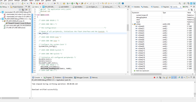

in debug mode keeping the rxData[20] in global and addded it into LiveExpressions, I'm facing an issue that rxData is not filling.

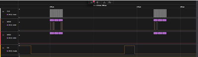

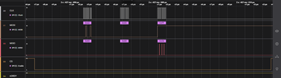

When I run this code, I got the output in logic analyser as given Screenshot
same SPI lines are connected to logic analyser lines, and the screenshot shows us the data on MISO line.
I'm transmitting 2 bytes and receiving 1 Byte. So, the total size I've given was 3.
rxData[3] is not being updated.

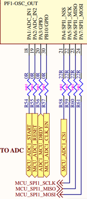

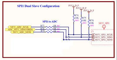

schematic lines from the ADC to STM32G070RBT6.
pullups are added for these three lines.
Thank you.

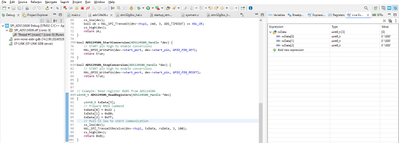

Hardware is working fine as we're seeing the output in logic analyser, but the firmware side is the problem.
I want the data to be stored in rxData buffer, but it is not happening. only 0x00 are in rxData buffer.

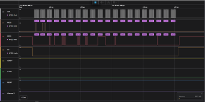

logic Analyser output.
zoom-out view
spd-kalyan

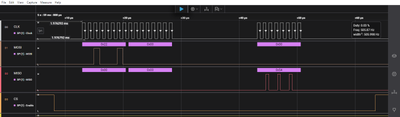

logic analyser output.

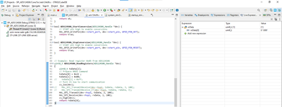

STMCubeIDE Debug mode Live expressions
Also tried transmitting the rxData on UART and checked in serial monitor, still the value is 0x00.

spd-kalyan
Hii @Andrew Neil

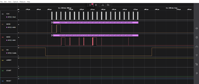

I wanted to share some observations from my recent tests with the STM32 MISO pin and the ADS124S08EVM. During my testing to verify if the MISO pin on the STM32 was functioning correctly, I shorted the MISO and MOSI pins to create a loopback while the ADC was also connected. Surprisingly, instead of receiving the data sent on the MOSI line, I received the expected data from the ADC. This was unexpected, and I'm curious about the reason behind this behavior.
Additionally, I noticed a difference in the MISO line behavior between the STM32 and the ADS124S08EVM. When using the ADS124S08EVM as a reference, the MISO line is initially high and goes low when data is received (high on pulses). However, with the STM32, the MISO line remains low and only goes high during pulses. Could this difference in the MISO line's idle state (high vs. low) be related to the issue? I've attached images for your reference.
STM32 Connected with ADS124S06 in parallel with logic analyser.
ADS124S08EVM SPI line connected with logic anaylser.
