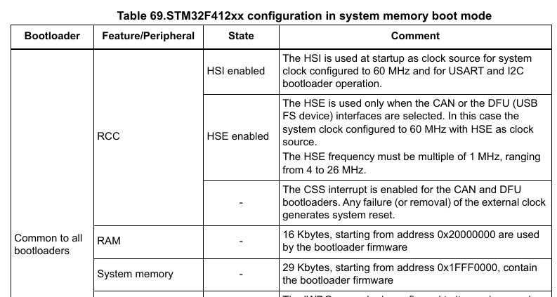

There are some older posts on the net about how to achieve a reboot in DFU mode but none of them worked for me. So I want to share my solution on how to add this functionality to your embedded firmware. First off all, I am using CUBEIDE with a STM32F412, but this method should work with all controllers. What you need:
1) The memory address of the bootloader of your MCU
2) The start address of your RAM
3) Some magic number of your choice (my favorites are 0xFEEDFEED, 0xDECAFBAD, 0xDEADBEEF, ...)
1) and 2) can be found in the AN2606 on the ST page. For my controller the relevant part looks like this:
So the address of the bootloader is 0x1FFF000 and the start address of the RAM is 0x20000000.
Now add a function to your source code that sets the magic number you chose and resets the controller. It could look something like this:
void reboot_into_dfu()
*((uint32_t *)0x20000000) = 0xDECAFBAD;
NVIC_SystemReset();
Replace 0x2000000 with the RAM start address of your controller and 0xDECAFBAD with the magic number of your choice.
