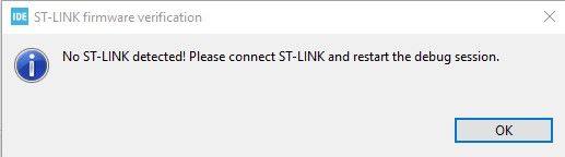

  3. after 1 week i finally got my STM32F407VET6 which has a mini USB. so i tried to connect it to my laptop. i tried to open a simple LED Blink but when i try to Run As or Debug As to 1STM32C/C++Application, it doesnt compile. it says "No ST-Link Detected! Please connect ST-LINK and Restart the debug session"

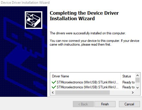

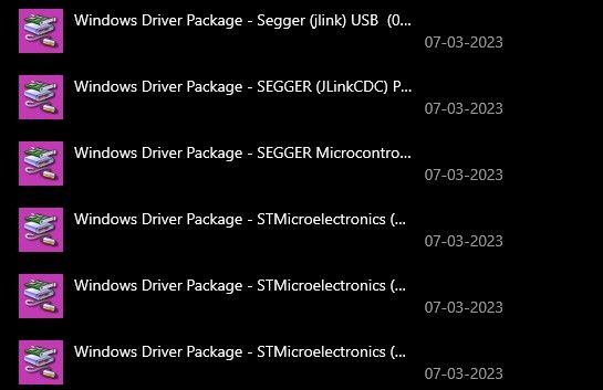

  5. ok cool. i downloaded both, extracted and tried them. first, i removed my usb cable then install Link009's file. just typical installation and everything seems ok 0693W00000aI68LQAS.jpg

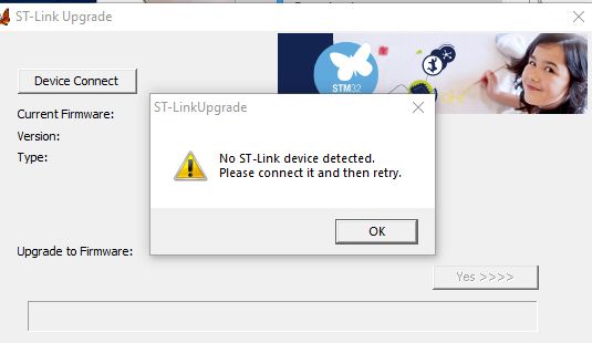

  6. now i tried to open the STSW-Link007 and reconnect my usb cable to my laptop. when i opened the STSW-Link007, this is where another problem kicks in: as you can see below it there is another error 0693W00000aI68uQAC.jpg
So im very confused. i can't progress at all. first there is no ST-Link detected in STM32CubeIDE and now to STSW-Link007. So i would like to ask. where did i go wrong? I've been doing this for 1 and a half day ever since it was delivery but nothing works. I highly appreciate any help. This is my first time interfacing with STM32 pheripheral so there might be something i missed....

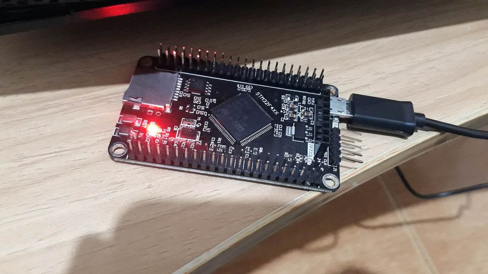

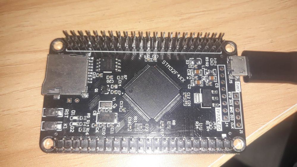

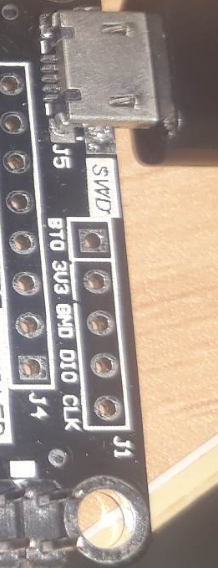

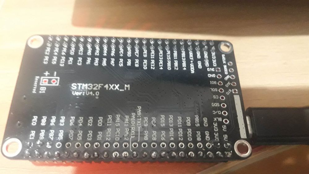

My STM32f4070693W00000aI6AMQA0.jpg0693W00000aI6AWQA0.jpg0693W00000aI6ARQA0.jpg

ST-LINK is a separate chip used for debugging. Seems that your board doesn't have it. Find the schematics of your board and try to attach a separate ST-LINK dongle. Or, easier: get a genuine STM32F4DISCOVERY or STM Nucleo board which already have it.

on your dev-e board is no STlink, you have it to connect here:

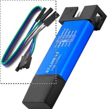

0693W00000aI8w4QAC.pngSWD connector: gnd, swd(dio), swc (clk) ; solder pin header here, connect to some debug probe : Jlink, STlink , ...

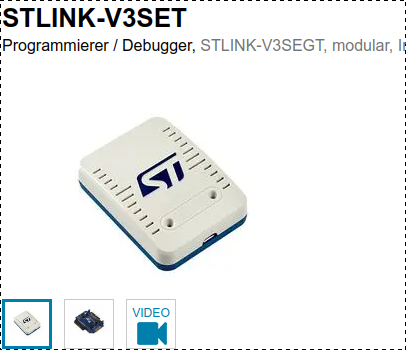

maybe some cheap clone:
0693W00000aI9AKQA0.pngor better :

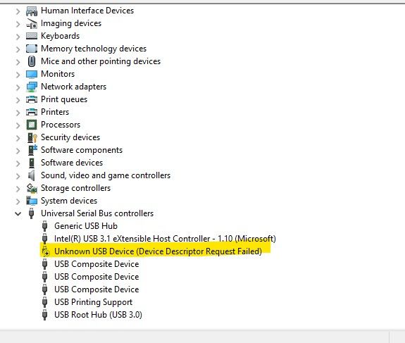

0693W00000aINCjQAO.jpg0693W00000aINFOQA4.pngI installed the driver from the st website still i get the same error. The " Getting started" steps are working, the tilting LED response and cursor movement when I connect both cabled to the laptop but when I go to debug my Target program of a simple "Hello World " the same error shows :"No ST- LINK detected.Please connect the ST-LINK and restart the debug session"
0693W00000aIMvUQAW.jpgWhen I do connect the board,Control panel shows the following change and this appears saying "Unknown USB Device(Device Descriptor Request Failed)" while the Board still has the running pre-loaded program of 4 LEDs and MEMS(if if push the button) meaning the power is reaching through my cable

First, check that your ST-LINK is not damaged.
Disconnect it from the target and connect (the USB end, of course) to some other good PC.
It does not matter if ST-LINK driver is not installed there (or you don't know) - do not install anything.
Open Device Manager and look for the ST-Link there (even if driver is not installed, it will be visible under USB devices). On Linux, use sudo lsusb.
If not visible, or "Device Descriptor request failed" - try to replace the USB cable and/or connect thru a powered USB hub.
If nothing of this helped, your ST-LINK likely finished its useful life.
​Otherwise, connect ST-LINK to the target and check again. Still alive? Great, move it to your work machine (where you have installed the drivers and the rest of tools).
