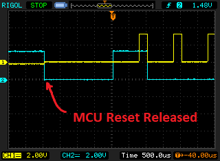

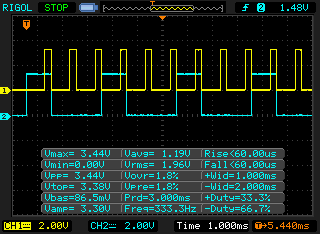

Here is the output of TIM3 and TIM5.
0693W00000KcqjOQAR.bmpTIM3 in blue, TIM5 is yellow.
0693W00000KcqmmQAB.bmpConclusion: I obviously don't exactly understand what output compare fast enable does. Can anyone give alternative explanation of what happens when I use it?

Actually, now the thing worked. There is a momentary pulse in the beginning (TIM3 goes low for 2us - with 2kHz clock! - and then the whole firs period is HIGH), and it actually IS activating TIM5 immediately now. All I did was clean up some code, remove Fast Enable everywhere I had it, and put it specifically on TIM3 again (to pass TIM1 enable through to TIM5). And it did indeed have the whole 1st period as HIGH, setting off TIM5 right away. Seems like I actually got everything right, just overlooked or missed something on software side. Thanks for giving a reason to look through stuff again and make sure it's all correct, it fixed it. I think, fundamentally I understood what it is and what it does, and this was the whole purpose of this question. Many thanks.
