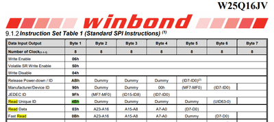

hello,
W25Q16JVZPIQ this is flash memory i am interfacing with stm32u575rit6.. I configure QSPI driver generated for ospi.  can you give any example to get device id.

Unfortunately, we cannot provide all the examples. You can try implementing it yourself. If you face any issue, we are here to help.
You need to check the datasheet first.

Example of READID command dispatch on STM32U5 OCTOSPI to QSPI Winbond / Micron / Macronix NOR Flash devices.  https://github.com/cturvey/stm32extldr/blob/main/ospi_qspi_readid.c
