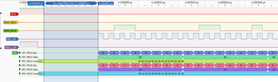

after setup SPI1 and setting CSTART=1, I expected that SPI is send immidiatly on bus.
(I toogled PE00 with CSTART=1)
I couldn't find some that explains that behaviour. It behave  the same, if I use DMA or writing directly to TXDR.
Do you have an idea ?
My testcode.
  SPI1->IFCR = 0xFFFF; // Clear all flags
  MODIFY_REG(SPI1->CR2, SPI_CR2_TSIZE, BufferSize);
  SPI1->CR1 |= (SPI_CR1_SPE);
  SPI1->CR1 |= SPI_CR1_CSTART;
  GPIOE->ODR &= ~(1 << 0);
  for (u32 i = 0; i < BufferSize; i++)
    LL_SPI_TransmitData8(SPI1, pBuffer[i]);
CPU is set to 160Mhz and SPI Prescaler is 256

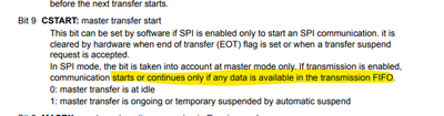

Saket_Om
Hello @FKaes.1
This bit is set to start SPI communication. However, communication cannot start if there is no data available in the TX FIFO.

Hi, I changed it for testing to "front load" the FIFO with some bytes. Bu still same behavior.FKaes1_0-1747115412512.png
  for (u32 i = 0; i < 8; i++) // front load before start
  SPI1->CR1 |= SPI_CR1_CSTART; // start
  for (u32 i = 8; i < BufferSize; i++) // send the remaining bytes
FKaes.1
For testing, I set the SPI Prescaler from 256 to 32. Then the delay was reduced by factor 8, too. So, I assume it is not caused by SW.
At the end, this isn't a problem for me. I was just interessed, if  this was caused by a wrong setup or usage by my side.

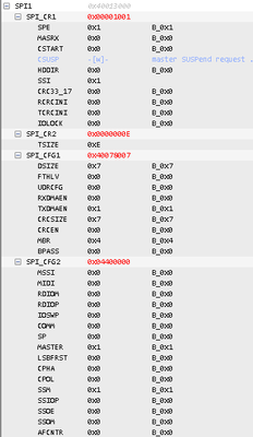

Hello FKaes.1,
Such delay can appear if MSSI bits of CFG2 register are not set to their reset values.
Could you verify this register please ?
Also I suppose your SPI is configured in Master mode, otherwise it is the received master clock which triggers the start of transfer and not CSTART bit.
Best regards,
FKaes.1
This are the settings+config rigth before setting CSTART = 1.
MSSI = 0
Master = 1
HW SS is not indented to be used. Chip select is controlled by SW.
For testing, I set MSSI to the max. value and the delay increased. So, the direction seems to be right.
