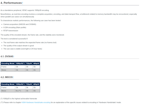

I would like to know the H264 VENC performance for the STM32N6 using the ST example: STM32Cube_FW_N6_V1.1.1/Projects/STM32N6570-DK/Applications/VENC/VENC_RTSP_Server
I have a hardware setup with a nucleo-n657x0-q + a ST B-CAMS-IMX camera module.
Question 1: The example provided by the STM32CUBE_FW is for STM32N6570-DK. Will it also work for the nucleo-n657x0-q
Thank you.
KDJEM.1
Hello @FB__1 ;
The VENC IP, integrated into the STM32/N6 device, provides hardware acceleration for H.264 and JPEG encoding.
For more information about the performance, I recommend you to look at
The VENC_RTSP_Server application runs on STM32N657xx devices. This application has been tested with STMicroelectronics STM32N6570-DK boards Revision MB1939-N6570-A03 and can be easily tailored to any other supported device and development board.
I hope this answer your request.
Thank you.
Kaouthar

Hello KDJEM.1,
I saw this post and I am strugling more or less with the same. Since the documents you are pointing to talk about external memeory, Is this still possible to run the VENC_RTSP_Server application  on nucleo-n657x0-q board. Has any one done this and got it running?
