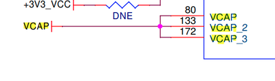

I am using STM32H7 dual core series. My STM32CubeIDE works fine when I am using HSI. But whenever I set the configuration to HSE, I am getting Break at address "0xa05f0000" with no debug information available, or outside of program code error. I tried different crystals, 8MHz & 25MHz, but this issue still persists.
Could you please tell me where exactly I am doing things wrong? Is the crystal setting just a reason for the error but the actual error is something different?

The caps on the HSE crystal should be connected to ground.
VCAP should have capacitors to ground, don't see VCAP connected anywhere else in the schematic.

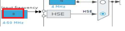

That's normal, in the schematics you have 25MHz as external crystal and your software sets it to 8Mhz so the MCU is overclocked.
You have to modify the value to 25 instead of 8.
So I have tried both 25MHz & 8MHz with the respective configurations but the issue was still there. Currently I have mounted 8MHz crystal.
The problem I am facing is, whenever I use HSE for configuring PLL the below issue occurs. Break at address "0xa05f0000" with no debug information available, or outside of program code. And the program especially Cortex-M4 stops.
mƎALLEm
@TDK thank you for pointing this out. I didn't notice this.
@HDesa.1 please review your schematics and refer to the AN4938 You need to have capacitors on VCAP pins.
You can also inspire from STM32H743_EVAL schematics
