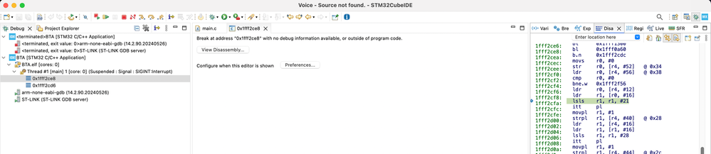

I am developing software on the Nucleo-L433RC-P board but have a strange situation when debugging.
The first time I debug, the software does not run and I get the following error...
Break at address "0x1fff2ce8" with no debug information available, or outside of program code.
Break at address "0x1fff2cd6" with no debug information available, or outside of program code.
As shown in the screenshot below...
However, the second time I debug it works correctly.
Why does it not work correctly on the first debug, but then works correctly on the second debug ?

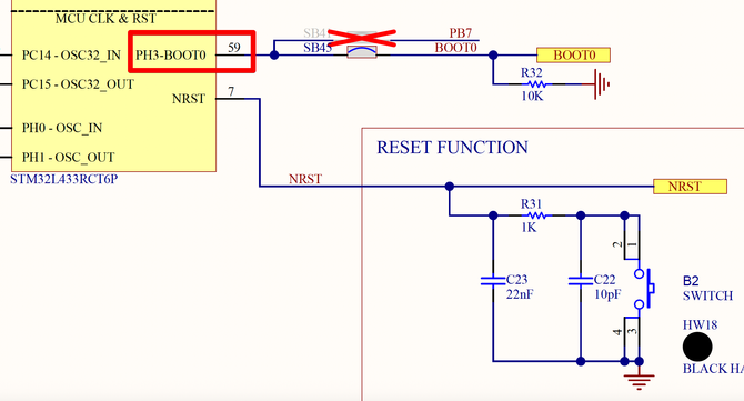

That's from the ROM, so either the BOOT0 is HIGH, or the FLASH is blank and doesn't contain viable vector table, so goes to ROM code instead.
BOOT0 is pulled low via a 10k resistor on this board and the pin on the header is floating

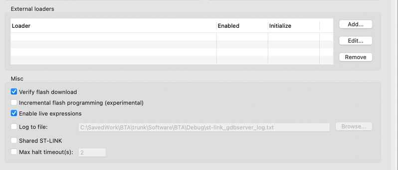

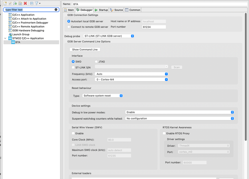

You'd want to look at the connection options chosen in the programmer.
The debugger might be resetting to gain control of the part, or to get a clear start.
The key take-away is that it's running code from ROM rather than FLASH, and has no source code to associate to that.

I've tried "Software system reset" and "Connect under reset" options, but it made no difference.
