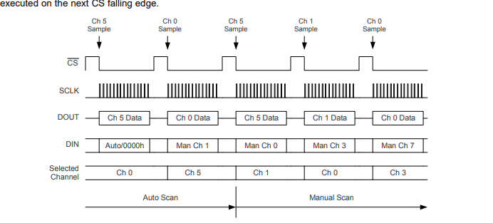

The error comes from triggering the SPI NSS pin.
First, I performed Hardware output Nss and saw that it did not write or read the register return value was 0. After Hardware I canceled NSS and turned it on and off with software. I wrote to the registers and read the correct data, but I could not read adc value. The problem right now is that I need to turn the CS pin on and off while receiving data via dma.
waclawek.jan
How? Show some timing diagram.
armco
When i  use manual CS (SSM =1, software slave management)  i can read data that I wrote the register but i use hardware use it doesn't work. I make debugging i see received data "0" because of time out.

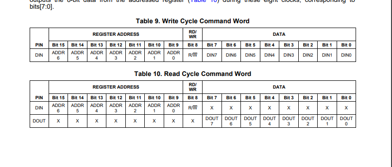

uint8_t Self_Control(uint8_t addres,uint8_t data)
uint16_t send_data = 0;
uint16_t recv_data = 0;
uint8_t tempL =0;
uint8_t tempH =0;
tempH = ((addres)<< 1);
tempL = (data);
send_data = (tempH<<8) | tempL;
// Transmit
//HAL_GPIO_WritePin(ADC_CS_Pin_GPIO_Port, ADC_CS_Pin_Pin, RESET);
HAL_SPI_Transmit(&hspi1, (uint8_t*)&send_data, 1, 100);
//HAL_GPIO_WritePin(ADC_CS_Pin_GPIO_Port, ADC_CS_Pin_Pin, SET);
// Receive
//HAL_Delay(100);
tempH = 0;
tempL = 0;
tempH = (((addres)<< 1) | (1 << 0));
tempL = 0x00;
send_data = (tempH<<8) |tempL ;
HAL_SPI_TransmitReceive(&hspi1, (uint8_t*)&send_data, (uint8_t*)&recv_data, 1,100);
return (uint8_t)(recv_data & 0xff);

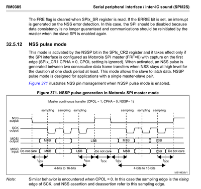

Check out NSS pulse mode:
Note that CPHA must be 0. Check with the slave's datasheet if this is viable.
I don't use Cube/CubeMX so don't know how to click this in CubeMX or what Cube/HAL incantations lead to this being properly used.
