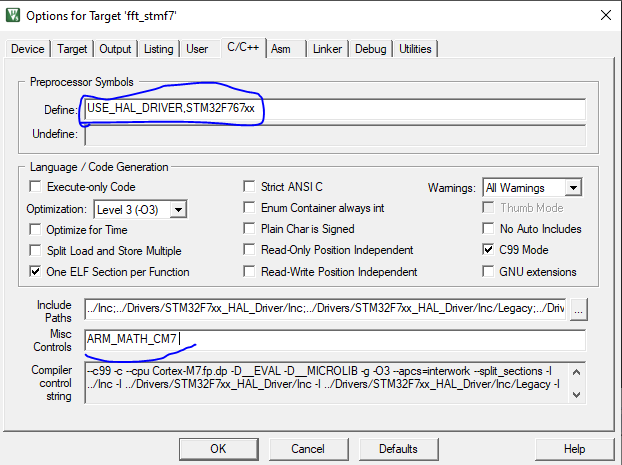

However I have defined in main:
#define ARM_MATH_CM7;
then I removed this code and did what it would do if it saw ARM_MATH_CM7
#include "core_cm7.h" but if gave 35 errors saying that:
..\Drivers\CMSIS\DSP\Include\arm_math.h(5791): error: #757: function "int32_t" is not a type name
and other funny things like that
I have added include and source paths and also Included them from Keil project window
any ideas???
>>However I have defined in main: #define ARM_MATH_CM7;
Normally you'd put it in the compiler's command line define list, and without semicolons
ARM_MATH_CM7
__FPU_PRESENT=1U
I'd expect stm32f7xx_hal.h to define uint32_t
otherwise stdint.h

Thank you Clive or your response
I am a little bit confused however
I am guessing I didn't specify it in a correct place.
where exactly do I need to write that down?
Do I need to add something to the blue circle related to CMSIS or do I leave it as it is
again, thanks for your response

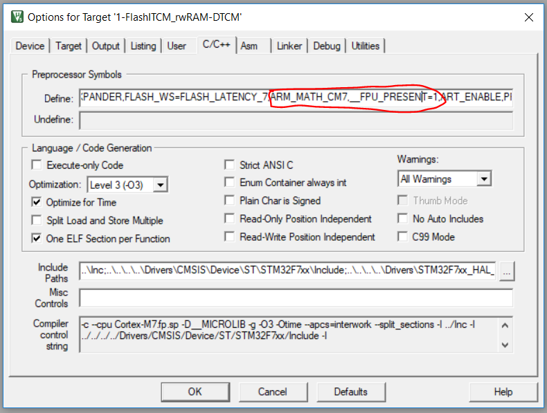

Hi @hashtala​ ,
If you didn't yet found the answer to your question: the new defines need to appear in "Preprocessor Symbols" section.
Look to the configuration used in the project STM32CubeExpansion_AN4667_F7_V4.0.0\Projects\STM32F769I_EVAL\stm32f7_performances for example:
This example with some other ones are available in the package X-CUBE-32F7PERF.
-Amel
