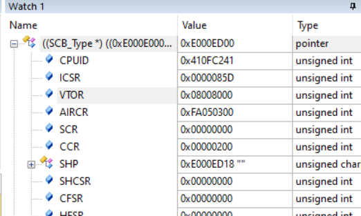

I am using STM32F429AG for one of our project. When i use vector table at its default position USB virtual com port works perfectly.
However, when i relocate the Vector table, my windows pc gives error that the USB device is malfunctioning. Other peripherals are working just fine after relocation.

Is SCB_VTOR register set properly?
Probably not setting SCB->VTOR properly in SystemInit(), ST could have used the linker symbol, but didn't...
SAkta.1
I have checked the VTOR using debug tool. It seems ok.
