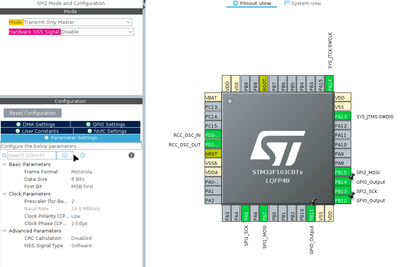

i am trying to interface 1.8 inch SPI TFT Display 128 x 160 to the STM32F103C8 using SPI2.
https://www.az-delivery.de/products/1-8-zoll-spi-tft-display
SPI1 is used for LoRa, i thought to connect TFT too to SPI1 using addresses but i am affraid to influence the
LoRa.
The library which i am using is from this website:
https://controllerstech.com/st7735-1-8-tft-display-with-stm32/
A year earlier i tried to interface LoRa to STM32F103C8 using SPI2 but without success.
Is it a general problem in STM32F103C8 using SPI2?

I have debugged RCC -> APB1ENR:
Bit 14 in RCC is set -> SPI2 is enabled

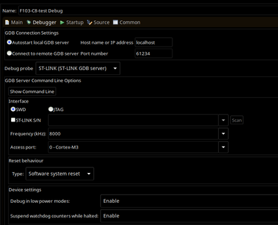

‎2024-02-16 1:42 PM
Yes i think wrong debug setting.
can you share your debug settings please for the bluepill?
Thanks

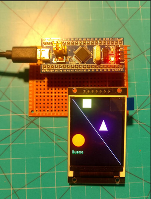

‎2024-02-16 7:01 PM
I tested it on a blue pill, on spi2, 72 MHz Core, 36 MHz APB1.
Works perfect with a 2 inch display.
‎2024-02-17 12:57 AM
@hamo , here debug setting:

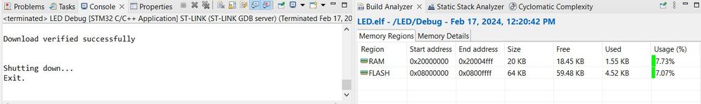

‎2024-02-17 3:28 AM
look at my settings just like your still not working.
Download successfully, and altough not working -> LED not blinking

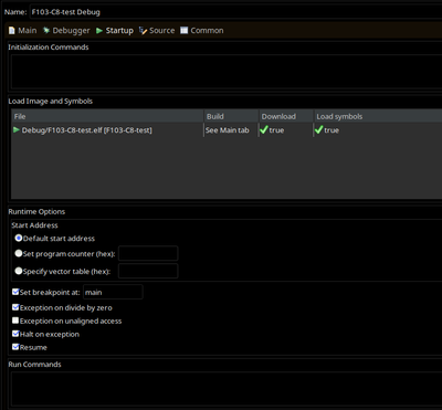

Seems it working ok, but you dont start debug , only download ; look at you startup setting ->

I lokked at my startuo settings, they are just yours.
i have tried to upload the code as .bin file using STM32 ST-LINK utility -> code uploaded but still not working, LED is not blinking.
