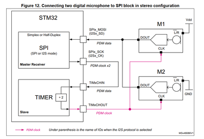

Since we have two PDM microphones, we've followed AN5027 "Interfacing PDM Digital Microphones":
In our setup, we have SPI2 SCK (mapped to PB10) connected to PA1, and connected PA9 to the DMIC_CLK line. Our plan has been to map PA1 (input) -> TIM17_CH1, which then triggers (via ITR8) TIM3_CH2 which is mapped to PA9 (output).
However, I'm struggling to set up the signals properly. I am able to configure TIM17_CH1 so that I can count SPI2_SCK. However, I am unable to trigger TIM3 to count at all.
I've attached my example project for the NUCLEO-WBA65RI board.
Any insight on this issue?

@AScha.3 For this example, I am using this shield: https://www.st.com/en/evaluation-tools/x-nucleo-cca02m2.html.
@Lionel Chastillon : I'm not sure I understand your response -- was this meant for me?
What has been working for me is setting up the SPI interface as a SPI half-duplex slave, and generating the clock with TIM17, and triggering TIM3 via capture/compare from TIM17. Is there any reason to be concerned about this approach?
