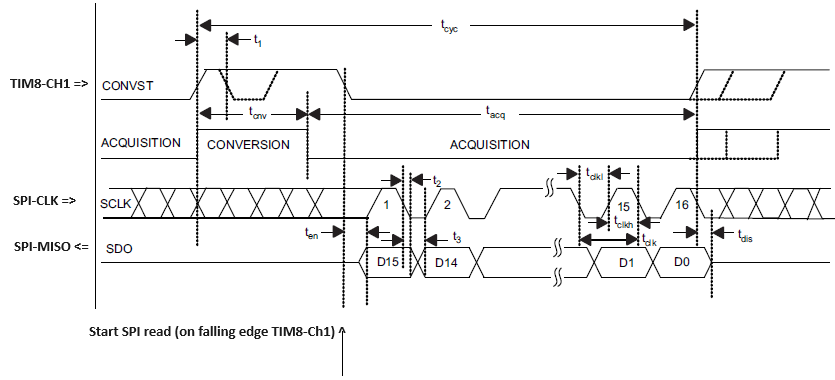

I want to digitize the analoge output of a linear CCD by an ADC with SPI interface. This ADC (ADS8319) needs a rising edge to start a conversion and >1.6us later it expects a serie of 16 Clock pulses to export its data. I have read an attractive solution for such challenge at the 'StackExchange' site, that sends dummy uint16 data to a SPI with DMA, triggered by a Timer.
A SPI in Full-Duplex mode, will produce 16 Clock-pulses to transmit an U16 word. The Timer must produce PWM pulses with the wanted frequency for the CCD readout. The rising edge of the pulse will trigger the ADC conversion, while the falling edge triggers the DMA transfer of a dummy uint16 to SPI, that produces the Clock-pulses needed by the ADC to export its data. The ADC's uint16 data is sent to the SPI MISO pin, to let it be transferred to the global data-array by another DMA action. The scheme below shows the timing:
Unfortunately, the organization of DMA on my MCU (BDMA, DMA with Mux, MDMA) is different from the STM32F746 on the 'StackExchange' forum, meaning the shown code snippets cannot be copied.
I configured SPI2 as Master in Full-Duplex mode with HW NSS signal handling, set 16bit frame-size, the baudrate and MSB-first. Despite many changes and different approaches, I have not been able to make SPI2 produce Clock-pulses, while the task looks quite simple: define and start a DMA action which, triggered by a Timer-compare event, writes a uint16 value to the SPI2 TXDR register.

Hallo Barry,
At first I want to express my appreciation for your help and attempts to convince me to be misunderstanding how the ADS8319 ADC must be handled to retrieve its data.
You may have been I misled you by my description of my configuration of the SPI peripheral: "Full-Duplex with HW NSS control". The reality is: I left the pins for SPI MOSI and NSS un-connected and applied the TIM8-CH1 PWM pulses on the CNVST input of the ADC. The timing scheme for '3-Wire CS Mode Without Busy Indicator (SDI = 1)' on Datasheet page 20 shows the following, I added my signals at the left and below:
I may seem a stubborn old ***, but I think this approach should be able to work (assuming I manage to program the SPI-read part). I already had a working situation with such layout, but running on a STM32F401CCU6 with an interrupt on TIM8 by DIER.CC1IE. The ISR was simple:
void Adapted_SPI_TxISR_16BIT(struct __SPI_HandleTypeDef *hspi)
/* Transmit data in 16 Bit mode */
hspi->Instance->DR = (uint32_t)(*hspi->pTxBuffPtr);
// don't update Tx-parameters, always transmit same word:
} // end of ISR 'Adapted_SPI_TxISR_16BIT()'
I was not satisfied with this solution because I had the impression the MCU could not handle 125k interrupts per second in a timely manner, causing some ADC conversions to be skipped.
The remaining question is now: is this approach feasible? or are you still convinced, I am thinking in the wrong direction?

‎2024-06-17 6:55 AM
At 84MHz system clock, you had 672 machine cycles per interrupt. While the ISR entry/exit, C function prologue/epilogue, qualifying the interrupt source and clearing it, may take around 50 cycles - maybe a tad bit more, if the ISR does nothing but pulling a variable and storing it into a peripheral register, that may push towards 100 cycles. Out of the 672. That's more than enough, provided you don't use other lengthy interrupt (e.g. USB) with the same or higher priority.
What I guess choked your mcu was the overhead brought in by Cube's method of handling the interrupts, possibly exacerbated by not using compiler optimizations.
‎2024-06-17 7:09 AM - edited ‎2024-06-17 7:22 AM
Fred, I wish you nothing but success with your chosen approach. It's possible it will work just fine. I think taking advantage of the hardware support for CSn in the SPI peripheral would be a far simpler (and natural, and perhaps even the manufacturer's recommended) way to do it, and I tried to push you in that direction. But it's your project - only you can decide on the direction you want to take.
You now know you can trigger a DMA directly from an output compare event (I laid out roughly how to go about it with Cube/HAL, and JW gave a detailed explanation at the register level). You said several times that implementing this was the primary obstacle. That means you've made definite progress and therefore all is well.
