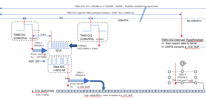

Hallo everyone,
As engineer who started to explore the world of MCU's years after my retirement, I regularly encounter problems that puzzle me for some time. However, since I'm stuck for several days now, I decided to ask for assistance by this forum.
For my project, I selected a high-performance MCU, (STM32H723VGT6) mounted on a WeAct test-board, because of its price and atractive form-factor.
I want to digitize the analoge output of a linear CCD by an ADC with SPI interface. This ADC (ADS8319) needs a rising edge to start a conversion and >1.6us later it expects a serie of 16 Clock pulses to export its data. I have read an attractive solution for such challenge at the 'StackExchange' site, that sends dummy uint16 data to a SPI with DMA, triggered by a Timer.
A SPI in Full-Duplex mode, will produce 16 Clock-pulses to transmit an U16 word. The Timer must produce PWM pulses with the wanted frequency for the CCD readout. The rising edge of the pulse will trigger the ADC conversion, while the falling edge triggers the DMA transfer of a dummy uint16 to SPI, that produces the Clock-pulses needed by the ADC to export its data. The ADC's uint16 data is sent to the SPI MISO pin, to let it be transferred to the global data-array by another DMA action. The scheme below shows the timing:
Unfortunately, the organization of DMA on my MCU (BDMA, DMA with Mux, MDMA) is different from the STM32F746 on the 'StackExchange' forum, meaning the shown code snippets cannot be copied.
I configured SPI2 as Master in Full-Duplex mode with HW NSS signal handling, set 16bit frame-size, the baudrate and MSB-first. Despite many changes and different approaches, I have not been able to make SPI2 produce Clock-pulses, while the task looks quite simple: define and start a DMA action which, triggered by a Timer-compare event, writes a uint16 value to the SPI2 TXDR register.
I sincerely hope I made myself clear and that some readers are willing to think with me about how to crack this problem. Thank you in advance,

  Dear Roman,
Thank you for your reply on my question, I really appreciate you took your time for it.
I'm sorry to say, I don't understand how your suggestion in the first two lines of your reply should work. I can configure SPI2 with DMA for transmission (Tx) and reception (Rx), but have not a clue how to connect my ADS8319 ADC to this configuration to achieve readouts of the ADC (which should be about a fixed number for a known fixed analoge input).
In your second alinea, you mention "implement TIM8 OC or PWM interrupt handler". My question just arose from the wish to bypass the use of interrupts on this time-critical appliance.
I would prefer a solution with a tiny, fixed delay, identical to the subject in a threat of another forum:
https://electronics.stackexchange.com/questions/353152/stm32f-how-to-config-dma-transfer-to-spi-triggered-by-timer
From the suggested solution I understood the following concept:
  1. configure a timer (TIM8 in my case) to create PWM pulses,
  2. configure DMA for TIM8,
  3. define the period equal to the ADC repetition rate,
  4. connect the PWM-output to the ADC 'CNVST' input (= trigger for conversion),
  5. define the pulse-length to the time difference between the ADC trigger (= rising edge) and the start event of the TIM-DMA (falling edge),
  6. configure the TIM-DMA to retrieve a constant uint16 value (from a prefixed address, no pointer increment) and transfer this value to SPI Tx-DMA register 'hspi2.Instance->TXDR',
  7. configure the SPI2-DMA-Rx to receive uint16 values on its RXDR register and transfer this value to the next index of a global data-array 'g_CCD_Buff'.
  8. a value on a SPI_TXDR register means the peripheral will transmit the bit-pattern on its MOSI-pin (= not connected), synchronous with clock-pulses on the SPI_CLK pin, which is connected to the ADC_CLK pin.
  9. if the duration of the TIM8 pulse is more than the ADC conversion time, the ADC will output its conversion value at its 'SDO' pin, on the rythm of the pulses on its CLK input,
  10. the ADC 'SDO' pin is connected to the SPI_MISO pin (so hspi2.Instance-> RXDR receives the ADC output),
  11. as SPI2 has a DMA configured for its Rx channel, the received value will become transferred to the next index of the global data-array.
I understand most actions described above and know how to implement them. But I I cannot figure out how to define a Timer-DMA to perform its action on a SPI peripheral.
Or, in case I understand it all wrong: how I can let a TIM8- OC1 event trigger a SPI-Tx DMA to execute.
I hope I made myself more clear now,
best regards,
Fred Schimmel

About 1): I have learnt the trick to transmit a dummy word on a Full-Duplex SPI to force the SPI peripheral to produce clock pulses that are needed for the ADC to output its conversion word. And the SPI-Rx side receives the ADC word and transfers that data to an array. It was mentioned that "Receive Only Master" expects external clock-pulses fed to its SCLK pin to synchronize. I may experiment with your suggestion, but in that setup I still need to trigger the SPI-rRx action to read the ADC data (which I don't know how).
About 2): In my text I didn't explain the complete setup of the application. There are 120,000us are needed for the complete readout of 3700 CCD-pixels. It takes 8us to convert a pixel, so 3700*8us = 29,600us for digitizing all. In the past I encountered problems with the export of collected data as ASCII stream, converting new data, so I decided to do it sequentially. Writing 3700 uint16 values as hex ASCII chars on a 921,600 Baud port takes ~80.3ms => one complete readout takes 109.9ms, rounded to 120ms.
About 3): Apparently, I failed to explain my reasoning (valid or invalid). I want to use the TIM8 PWM for two things:
  1. the rep.rate of the ADC trigger. Each new pulse should trigger a new conversion of a CCD pixel voltage, where the period is determined by the ARR register.
  2. the delay between the ADC trigger (start of the conversion by the rising edge) and the readout of the ADC data (by triggering a SPI-DMA action on the falling edge), the delay equals the pulse length, determined by CCR1.
The SPI clock frequency is only important.to be fast enough to read 16 bits from the ADC within 8us - ADC-conversion time (= ~6.2us), but not too fast to allow my HW to keep the pulses separated. And, as I already made clear, I want to read 3700 samples, per cycle, not one.
About 4): Maybe I'm wrong, but in my perception the suggested solution in the stackexchange example defines a Timer-DMA that is triggered by TIM8.OC1REF, just as you describe in the first two sentences of your point 3.
The next step is to configure this DMA transfer for another peripheral (SPI2), by the specification of the address of a uint16 constant as 'source pointer' and the the address of SPI2.TXDR as 'destination pointer'. Until here I think I understand this approach, but I miss how to program the last part: how to start the Timer-DMA.
I hope I finally managed to make clear my ideas,
many greetings from the Netherlands,
Fred Schimmel

 >  Each new pulse should trigger a new conversion of a CCD pixel voltage, where the period is determined by the ARR register.
The DS is a little hard to parse, but it looks like this ADC has several modes.
In "3-wire without busy" mode, IIUC, a conversion is started whenever CSn is deasserted (the SPI bus is idle). If you time your SPI read till at least tcnv later, you can have the STM32 read out the data at 33Mhz. All you need to do is figure out the right period in which to trigger the reads, and anything more than ~2us should be ok. I really think that might be all that's required.
Alternatively, in "3-wire with busy" mode you can have the ADC output an interrupt signal when data is ready, and you can configure the DMAMUX request generator to use this signal that to trigger a DMA write. This could work as well.
I just don't think using "Timer Output Compare" is a good solution here.
I'm gonna assume you'll relinquish the output compare idea.
For a timer to periodically trigger a DMA transfer, follow the StackExchange code.
The important steps are:
1. link the DMA to the timer with __HAL_LINKDMA() (or some such).
2. Set DMA mode (Peripheral-To-Memory)
2. program the DMA with src/dest addresses and width with HAL_Start_DMA.
3. use  __HAL_TIM_ENABLE_DMA(&htim, TIM_DMA_UPDATE); to allow the update event of the timer
to trigger DMA (this is important)
4. start the timer.
You cannot do (all of) this with CubeMX code generation.
Every time the timer overflows, the DMA will issue a DMA request to the SPI peripheral, which will
read the number of bits configured at the baud rate configured. When the data is read, it will signal the
DMA peripheral, which will read the data and store it in memory. That's it.
First, have a look at Figure 1 System architecture in the RM. The MDMA is probably not very helpful in this situation, it's mostly aimed at heavy lifiting in the AXI domain. BDMA is mainly aimed at working autonomously, when the rest of the chip is in sleep, within the low-power domain, and it doesn't have access to peripherals beyond that domain (except AHB3/APB3).
Thus assuming you are going to use one of the DMA1/DMA2, set up trigger first. In the timer, enable DMA from the source you want to (Update, or one of the Capture/Compare channels, by setting respective TIMx_DIER.UDE/CCxDE). In DMAMUX1, look up in Table 118. DMAMUX1: assignment of multiplexer inputs to resources the trigger from timer, and write it to one of the DMAMUX1_CxCR.DMAREQ_ID - the x there then determines, to which DMA Stream will be this request routed.
You then set up that DMA Stream to perform the transfers from memory (beware of caching issues) to given SPI data register or FIFO (the 'H7 SPI is again an overcomplicated beast, much more complicated than SPI in 'F7 or other families; and I am not familiar with it so can't give specific clues for that) by setting the SPI data register address in DMA Stream's Peripheral Address register, memory buffer address in Memory Address register, number of transfers in NDTR, set the appropriate direction, transfer size, etc. in Control register. You don't need to use FIFO at this point.
This may or may not be that simple to click in CubeMX. I don't know, I don't use Cube/CubeMX. Generally, Cube inevitably implements only a fraction of what the hardware is capable of - whatever Cube's authors deemed "typical" - and is helpful as long as you want something from that fraction. Otherwise it may or may not get into your way more than help. Now you've been warned.

@waclawek.jan just replied to someone in another thread and he made me realize something I didn't before (thanks for that).
You can indeed trigger a dma directly from an output compare/Input capture event. You do not need the DMAMUX (though you might be able to do it that way too).
Again, you can't do it with CubeMX, but you can get a sense of how to do it by enabling a timer and then setting
a DMA channel with DMA request "TIMx_COM". Generate the code, then look at the implementation
of `HAL_TIM_OC_Start_DMA`. It hardcodes the source/target peripheral address to be one of the timer's registers (*), so it's unusable for general purpose, but other than that it's a complete example of how to trigger DMA from a timer event.
To settle this once and for all, the list of DMA triggers sources is plainly listed in the RM in the documentation of the  TIMx_DIER register. I should have checked this, but I did not.
And yes, I still claim this is the wrong way to do what you're trying to do.

> I had the impression the MCU could not handle 125k interrupts per second in a timely manner
At 84MHz system clock, you had 672 machine cycles per interrupt. While the ISR entry/exit, C function prologue/epilogue, qualifying the interrupt source and clearing it, may take around 50 cycles - maybe a tad bit more, if the ISR does nothing but pulling a variable and storing it into a peripheral register, that may push towards 100 cycles. Out of the 672. That's more than enough, provided you don't use other lengthy interrupt (e.g. USB) with the same or higher priority.
What I guess choked your mcu was the overhead brought in by Cube's method of handling the interrupts, possibly exacerbated by not using compiler optimizations.
FredSAuthor
Senior
June 17, 2024
    Hallo Jan,
After stating that 8us were more than enough to handle the interrupt you made a reservation "provided you don't use other lengthy interrupt (e.g. USB) with the same or higher priority".
Just that was the case: I also added code to export the collected data as a stream of hex values in ASCII by means of USB_OTG_FS, which is a big piece of code and probably will consume a lot of CPU cycles.
Anyway, thank you for pointing out that the simple ISR alone would fit in the available time on a 84MHz clocked MCU.
Have a nice day,
Fred Schimmel
