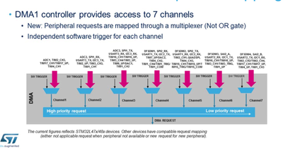

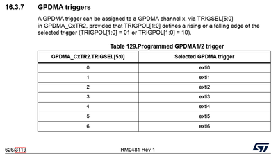

AScha.3
You have to read in rm of your chip, whats possible on this chip, here example from H563 manual, GPDMA :
pin on exti mode -> trigger on rising or falling edge :
Then you know, whats possible on this chip.
Or try to select in CubeMx (for your chip!) , it should show , whats possible triggers for a DMA channel.

> I'm hoping there is a way to trigger a DMA channel to transfer data with a GPIO without a timer in between.
Repharsing: you want to trigger a dma when there is a voltage transition on a physical pin. In STM32-world this is not called GPIO, but EXTI (Extended interrupt), and it is possible. As @AScha.3 states, the way to do it depends on your device family, and the reference manual is your guide.

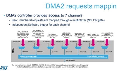

Here's what I've been looking at for the STM32l432KC, It's difficult for me to parse out what I'm looking at. I don't explicitly see any GDPMA or GPIO events. I do see plenty of TIMx_CHx.
From what waclawek.jan said, any TIMx_CHx feeding the DMA controller set in input capture mode should be able to trigger a data transfer on a selected edge. Correct?

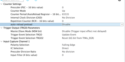

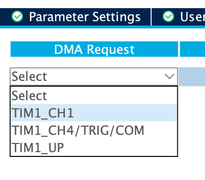

Here's the settings for TIM1 in CubeMX I think I need for input capture:
No clock for input capture, Trigger event selection? Do I need one, or do I use TIM1_CH1 for the DMA? What is TIM1_CH4/TRIG/COM, compare match. I don't think that's what I need? Can I use TIM1_UP?
I suspect I want TIM1_CH1.

Ignore TRG0, this is for triggering one timer from another, not relevant to your task.
Timer Input capture is a way to trigger an event from an external pin. a DMA from TIM1_CH1 is what you want but be aware that CubeMX will not do what you expect. It will program the DMA trigger source appropriately, but the provided  HAL_TIM_IC_Start_DMA API  hardcodes the peripheral addr for the DMA to be timer->CCR1. Not what you want. You can however copy HAL_TIM_IC_Start_DMA into your own function and easily modify it to DMA wherever you want.
I'm literally having this same conversation right now in another thread. This is a pervasive usability issue with CubeMX, and I'm going to open a bug report thread about it.
Configure the input capture section to trigger on whatever you need, rising/falling/both. That's what determines when an event is generated, and whenever that event is generated a DMA trigger will occur.
As a sidenote, if your external interrupt source is noisy (like a bouncing mechanical switch used during testing), be aware that the input capture mode provides a "filtering" functionality, i.e. hardware debouncing - which can be very handy.

I ran CubeMX with TIM1 set as input capture and generated code. I think this is the line BarryWhit is referring to:
__HAL_LINKDMA(tim_icHandle,hdma[TIM_DMA_ID_CC1],hdma_tim1_ch1);
I think I want to link it like this:
__HAL_LINKDMA(tim_icHandle,hdma[TIM_DMA_ID_UPDATE],hdma_tim1_ch1);
and then what I think I want is to do is:
HAL_DMA_Start_IT(&hdma_tim1_ch1, (uint32_t)clockedData_1, (uint32_t)&(GPIOB->BSRR), 13);
I'm assuming UPDATE occurs every edge that's being watched.
