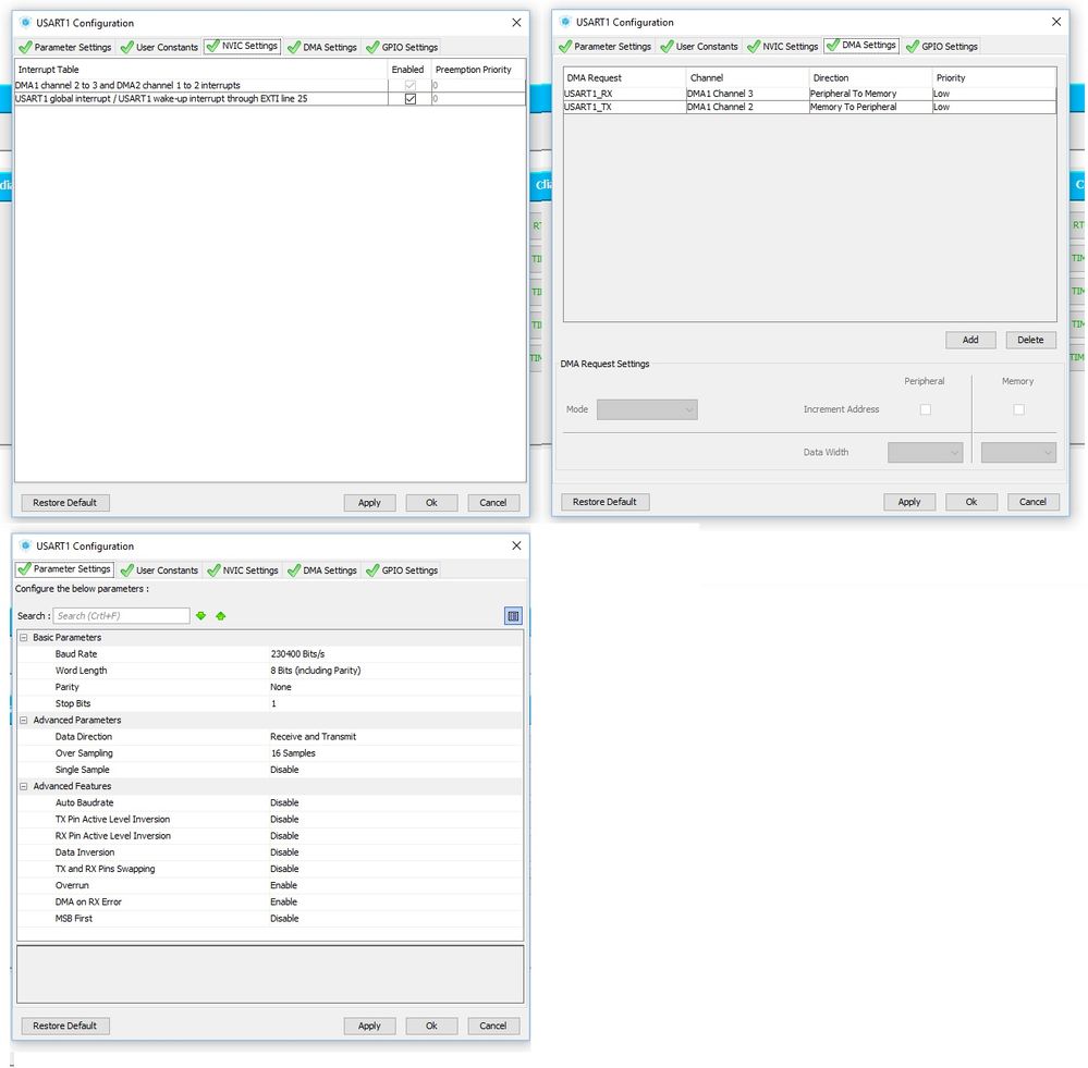

I use this to transmit by DMA, but the code should show you what you need to know;
    if (TxDMA1BufHasData) {
        char uartState = HAL_UART_GetState(&huart1);
        if ((uartState == HAL_UART_STATE_READY) || (uartState == HAL_UART_STATE_BUSY_RX)) {
            TxDMA1BufHasData = false;        // sending now
            if(HAL_UART_Transmit_DMA(&huart1, (uint8_t *)Usart1TxDMABuffer + U1TxBufferPtrOUT, U1TxBufferPtrIN - U1TxBufferPtrOUT) == HAL_OK) {
                U1TxBufferPtrOUT = U1TxBufferPtrIN;
                Usart1TxDMABuffer[U1TxBufferPtrIN] = 0 ;    // null not needed
            else {
                _Error_Handler(__FILE__, __LINE__); /* Transfer error in transmission process */
Posted on January 30, 2018 at 05:18
I see for the transmission data you are casting '(uint8_t *)' instead of to the address '(uint8_t *)&' which I tried but it still is not working. Other than that I'm not sure what part of your code can help me understand what I'm doing wrong.
Posted on January 30, 2018 at 06:53
it doesnt look like you need DMA, its all I have to offer..
Thats the runtime use of the code that works for me, other than that I have the same init code from the cube.
but how did you initialise the port inside the cube ?
To make it work like this, you need to configure the Usart to use the DMA, inside the cube.
