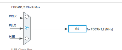

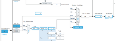

Clock: HSI 16 MHz → PLL → 64 MHz FDCAN clock

hfdcan1.Init.NominalPrescaler = 1;
hfdcan1.Init.NominalTimeSeg1 = 101;
hfdcan1.Init.NominalTimeSeg2 = 26;
hfdcan1.Init.DataPrescaler = 1;
hfdcan1.Init.DataTimeSeg1 = 24;
hfdcan1.Init.DataTimeSeg2 = 7;

What is the target bitrates in FDCAN mode: nominal and data phase?
As we don't support Raspberry Pi, you need to ensure you set correctly the FDCAN parameters from that side (timings, mode etc) ..

void SystemClock_Config(void)
  HAL_PWREx_ControlVoltageScaling(PWR_REGULATOR_VOLTAGE_SCALE1);
  RCC_OscInitStruct.OscillatorType = RCC_OSCILLATORTYPE_HSI|RCC_OSCILLATORTYPE_LSI;
  RCC_OscInitStruct.HSIDiv = RCC_HSI_DIV1;
  RCC_OscInitStruct.LSIState = RCC_LSI_ON;
  RCC_OscInitStruct.PLL.PLLSource = RCC_PLLSOURCE_HSI;
  RCC_OscInitStruct.PLL.PLLM = RCC_PLLM_DIV1;
  RCC_OscInitStruct.PLL.PLLN = 8;
  RCC_OscInitStruct.PLL.PLLP = RCC_PLLP_DIV4;
  RCC_OscInitStruct.PLL.PLLQ = RCC_PLLQ_DIV2;
  RCC_OscInitStruct.PLL.PLLR = RCC_PLLR_DIV2;

1- You are using HSI as clock source for FDCAN which is not recommended:
Please use STLINK MCO as clock source for the MCU (HSE in Bypass mode) with frequency input set at 8MHz:
2- Why are you setting FDCAN clock (64MHz) > System clock (32MHz)?
The FDCAN requires that the CAN time quanta clock is always below the APB clock. Please read this article: FAQ: Fixing STM32 FDCAN communication disruptions - APB bus, kernel, and time quanta clocks

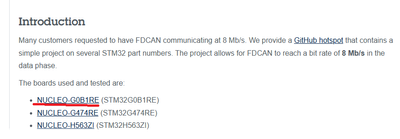

I invite you to refer to this knowledge base article: STM32 FDCAN running at 8 Mb/s on NUCLEO boards
 NUCLEO-G0B1RE board was already used:
The project is in this Github hotspot.
Hope that helps.
